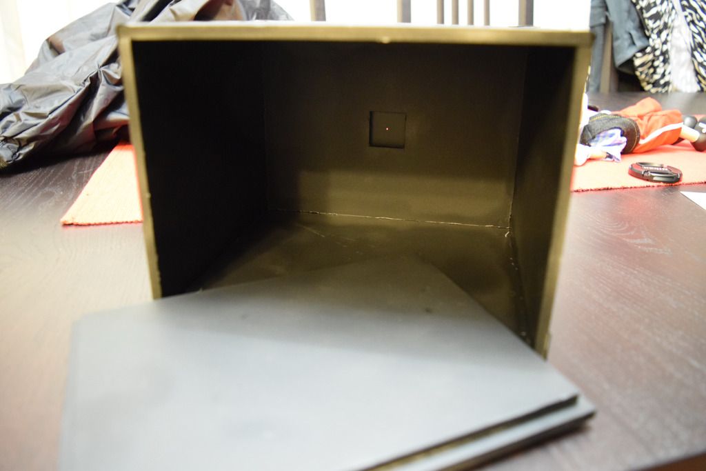

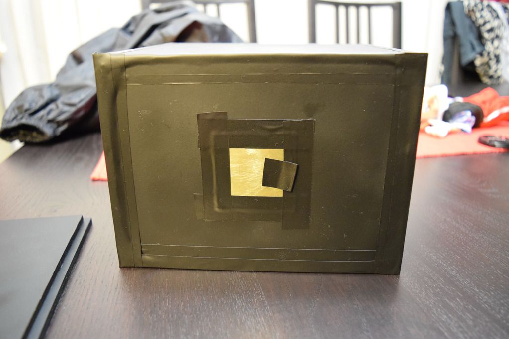

So I built a camera today and gave this a go.

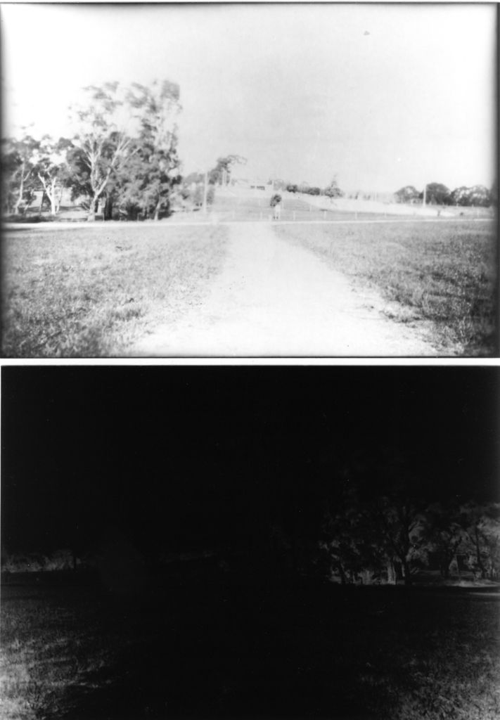

The scan's not the best but the positive image looks roughly right. They were scanned together so the negative actually is quite dark, though obviously there's still detail there.
I'm not too sure what's going on around the edges. It may just be the light creeping under when printing. I also need a way to get it level and stop it moving in the wind too.
Thanks. Yeah it's 5 by 7. Ilford multigrade rc. The whites don't look that white in truth by the way, but if I don't scan as greyscale I get this weird green cast.
