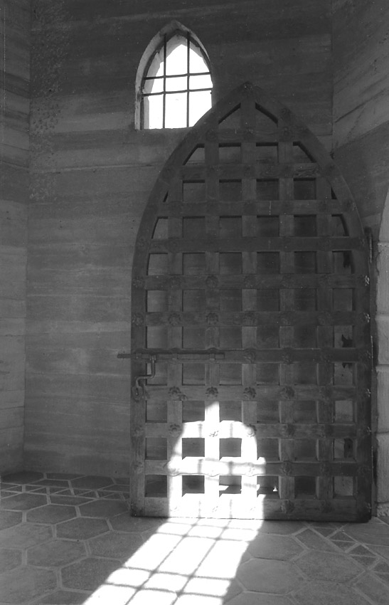

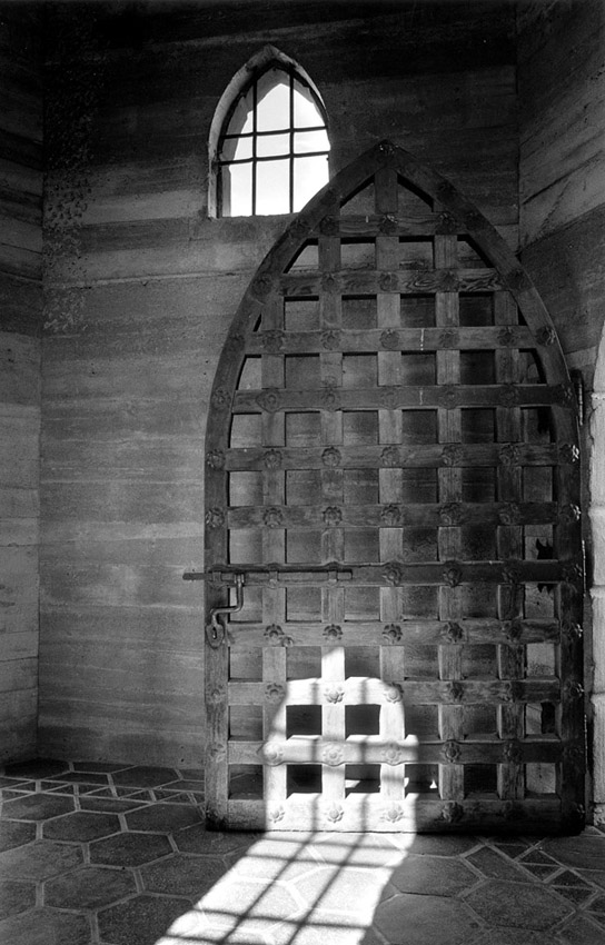

Here's one print I did with a combination of split-grade and dodging/burning. This is with a diffusion-head enlarger on Ilford MG RC paper. The first is the straight test print at grade #2. I remember I overexposed the film slightly (TMax100) to ensure I didn't lose any shadow detail. If I print this at a higher contrast, the highlight areas didn't change much, and printing longer just made everything darker overall. For the second print, my overall base exposure was at grade 4.5 (20 sec), (dodging the upper center of the door briefly) which brought out the texture in the walls and door. At grade #3, I burned the floor for 50% (10 sec) more time, the upper left corner for 50% and the upper right corner for 60% more. Then burned the left side of the image (except floor) for another 50%. Switched to grade 0 and burned the lower highlight area for 300% (60 sec) more time. Any longer than that and halos start to show up. Also burned in the upper window for 200% more time to add some density and tone.

Wow this is a fantastic example. Thank you for walking through your steps on this negative. I tend to give up if I have to do too much dodging and burning, but this comparison really shows what can be accomplished with some time spent on a negative and some visualization of an end product.

Jimjm that is a fantastic example. Essentially you spotted that the walls floor and door lack contrast in their detail and thus a higher base exposure contrast fixes that first before using split grade dodges and burns to put bright and dark elements in the right place.
This is effectively opposite to how I have tended to work thus far, I have the RH analyser so tend to fix base contrast and exposure on the meter readings for the bright and dark elements where I can see things I want to look almost black or almost white. Then after looking at the test print I have used dodging and burning to change the tone of elements in the photograph for artistic effect. I can see from your example this would likely leave me with poor detail contrast on the various surfaces so thanks for that, will help me to visualise the print a bit differently sometimes.
