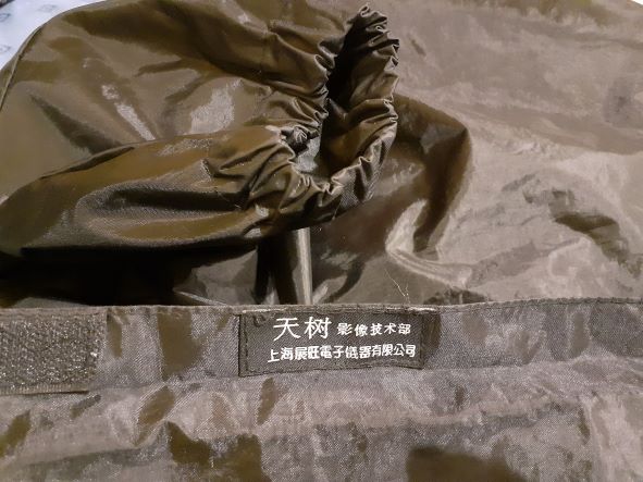

The one I have has both layers sewn together. Unfortunately, I don't have the original packaging, and the label reads this:
Maybe someone can help translating!
I don't remember where I bought it, though...

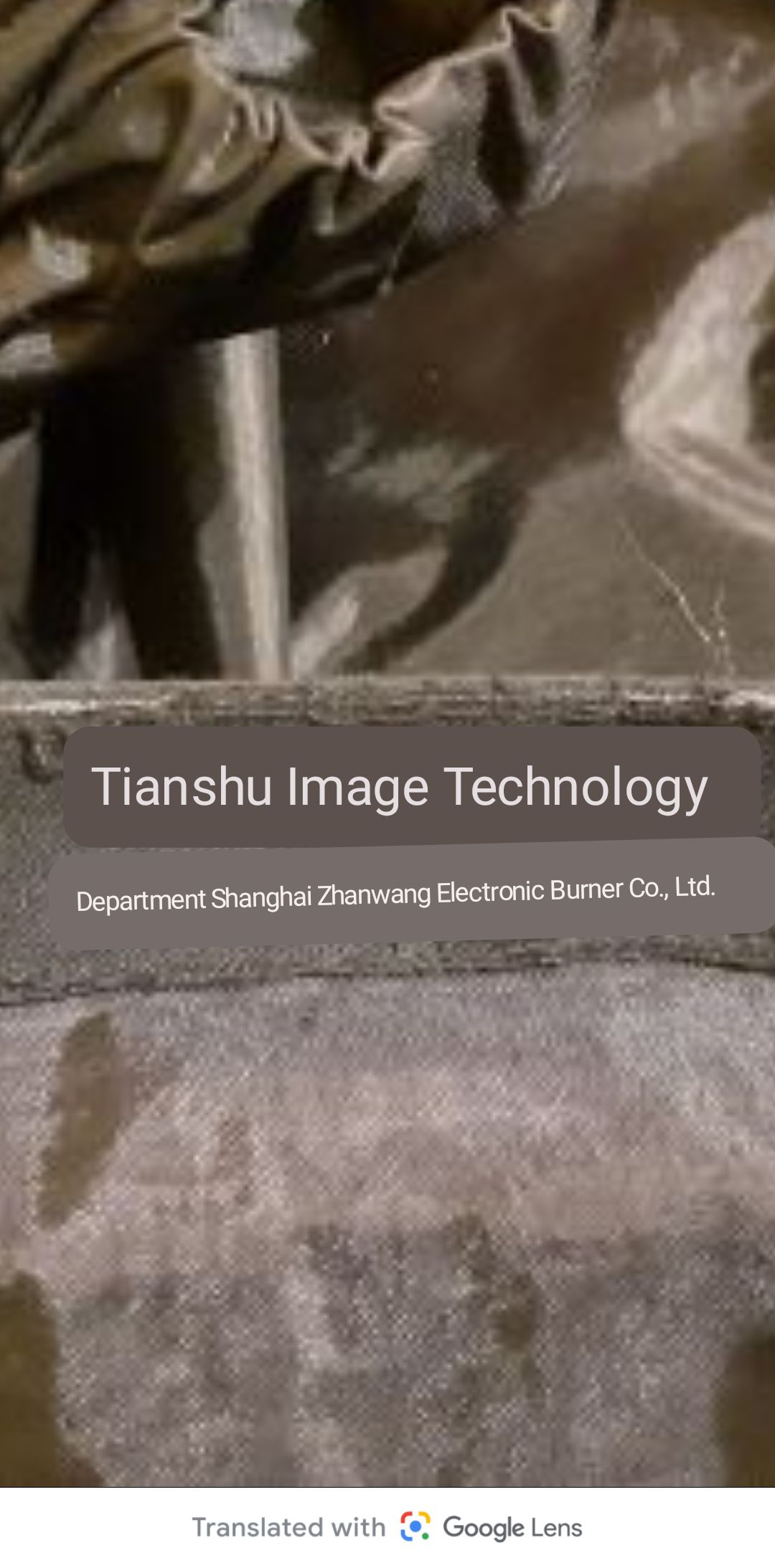

Hi Daniel a, I used Google Lens to translate the label in case you decide to forego the Photoflex and buy another of these in the future:
"Tianshu Image Technology Department Shanghai Zhanwang Electronic Burner Co., Ltd."
Thanks, Molli!

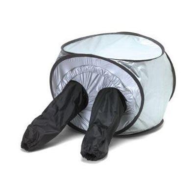

The Calumet film changing room is what I have used for 15 or more years. It is still available in the UK at £66.50 from Wex, who took Calumet over (or merged?) a few years ago. I am still using my first one and have another in reserve.
[Edit: I should have added that it is stored flat, in its own pouch. It springs open easily for use]
I bought an identical bag from China. Can’t remember what it cost. Unfortunately, pouch was lost in house fire.
This bag is roomy and comfortable. I use it for everything from Minox to 4x5.

This changing room mentioned in several post above have a wire structure that compresses flat and is popped up when using to provide a large non collapsing volume to work in. Much like the one in post #23 but with the arm sleeves coming in from opposite sides.
