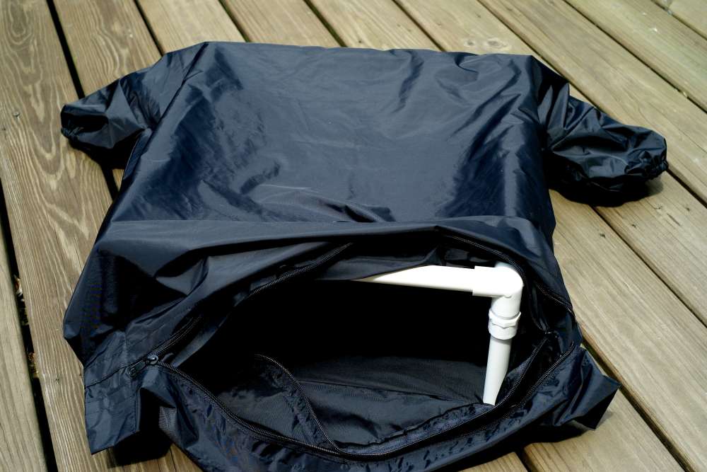

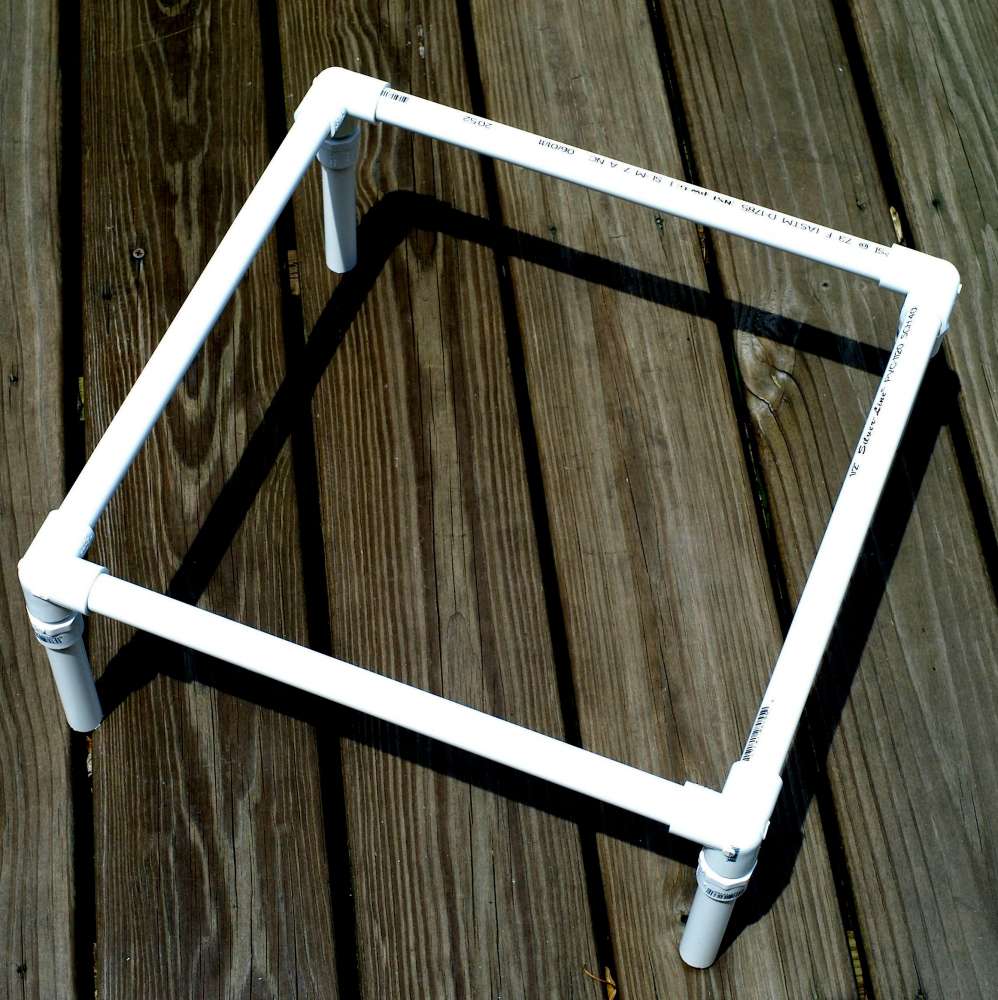

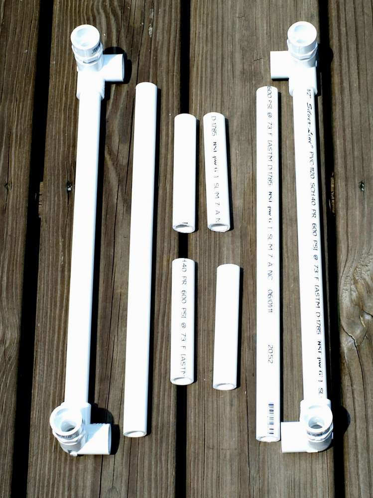

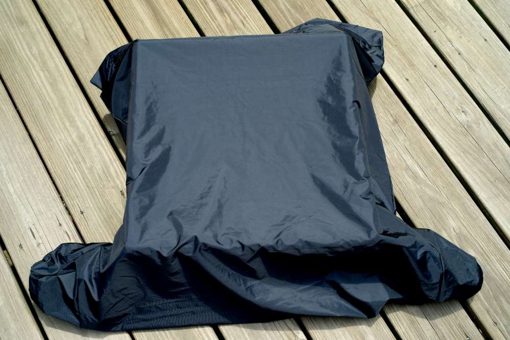

I tried the cardboard box idea and it helped a lot actually. I thought I would take it a bit further. So today I picked up 4 outside 90 PVC joints in 1/2" and some 1/2 tubing. The outside 90 degree joints have 2 slip connections and one threaded, the only ones I could find, so I had to get a threaded adapter to slip connector to make all three joints slip together.
What I made was an inside tent frame for my changing bag. It holds open the bag to just about as tight as it will go and still zip closed with ease. One has to slip the legs on once the square frame is inside the bag.
Parts List
(4) 14" cuts of 1/2 PVC [easy to cut off a 10' length]
(4) 4.5" cuts of 1/2 PVC for legs
(4) Outside 90 degree connectors
(4) Threaded to slip connectors [since one end of the outside 90s are threaded]
I will pick up (4) 1/2" caps next time I swing by Lowes because it will help extend the life of the inner changing bag liner from the edges of the PVC legs.
Made some quick happy snaps of the bag with the frame inside the bag, and of the frame and of the broken down pipe parts. I will load film holders in it soon and see how it works out. $ 8.00 in parts certainly beats a $100 or $200 changing tent if it works well.
