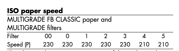

Is that normal to have 3 stops difference between filters? I use black and white filters which is usually less than half a stop difference.
Yes. Easily. Your filters are so close together because they're deliberately matched to be so. They block most of the blue light, and a tungsten/halogen lamp doesn't emit much of that to begin with. The blue emulsion is way faster than the green one.
I beg to differ. I rarely see 3 stops between filters. That would essentially be a fraction off one grade extreme or the other.
