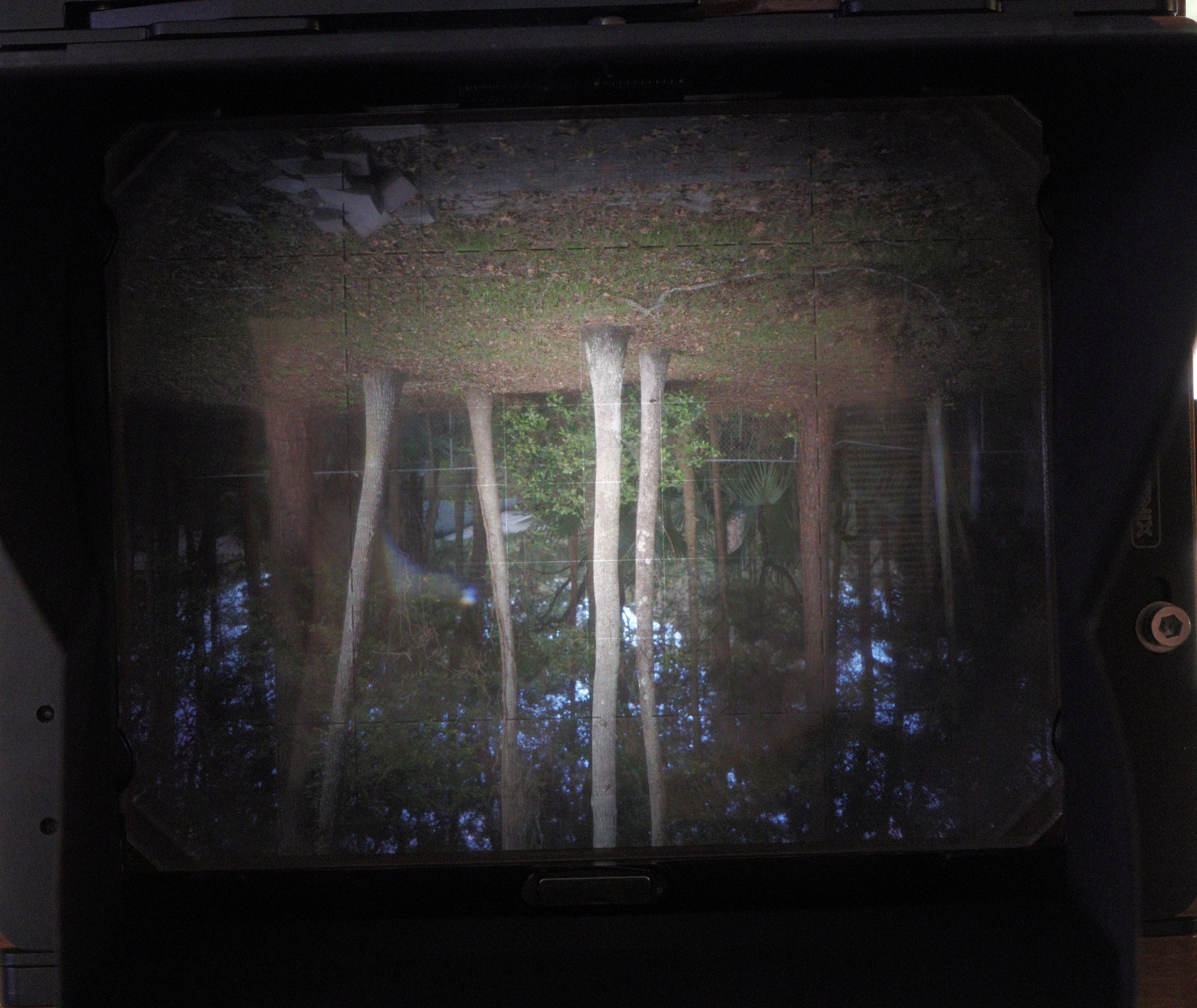

I don't see why not. This particular hood opens to the same dimensions as the ground glass.
Here's a shot with the hood in place-- it's very hastily done, so I'm not going to claim it's a great photo-- I didn't close the blinds behind me, the weather is a bit overcast, etc., but it's my worst lens (105mm f/5.6 with a poor image circle that just barely covers 4x5). Also, since I've got the fresnel in, the center will be brighter until you move your head (which I couldn't do with the camera).
Still, you can see the edges of the image in the ground glass pretty clearly.
