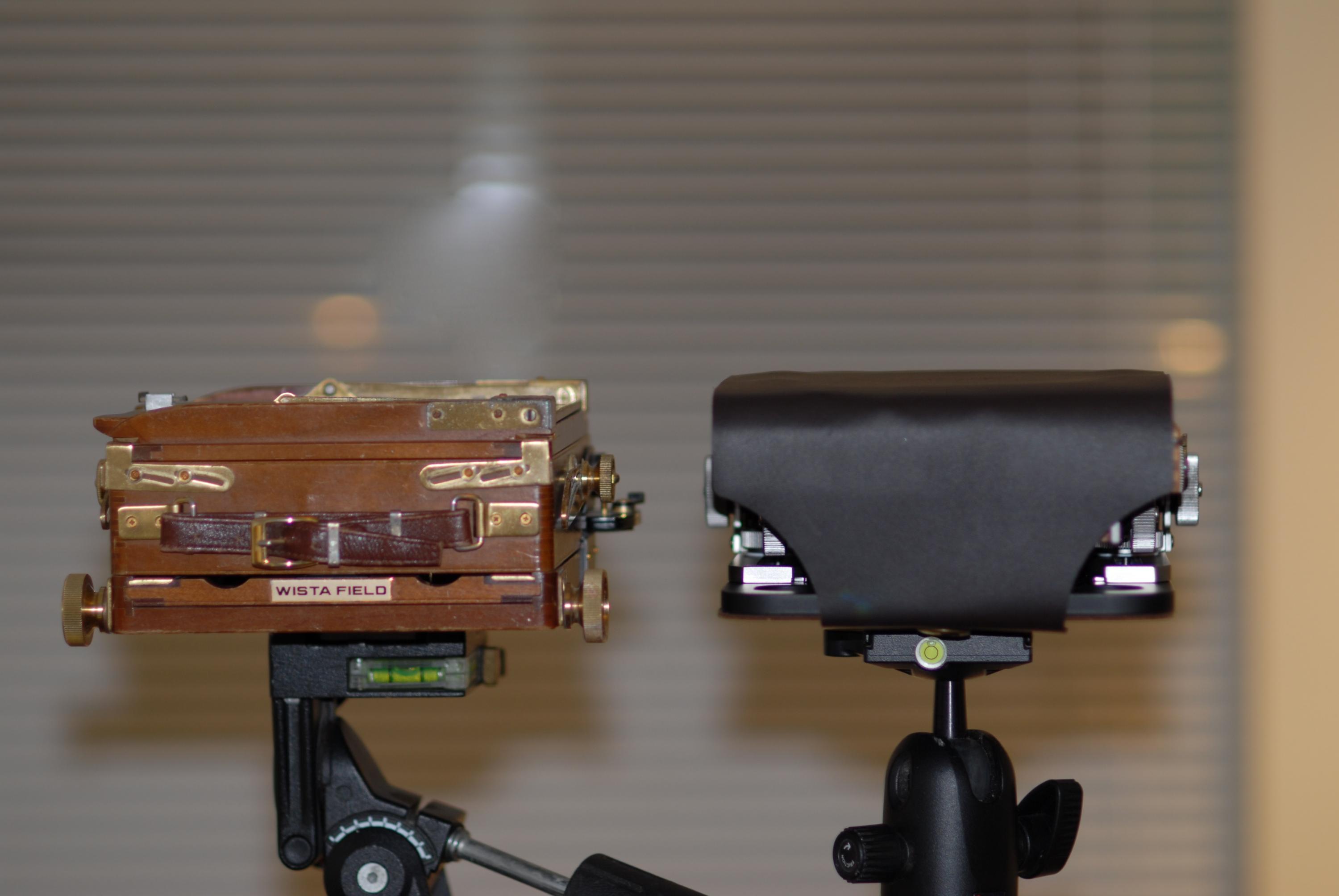

Here are the two cameras, folded, side by side:

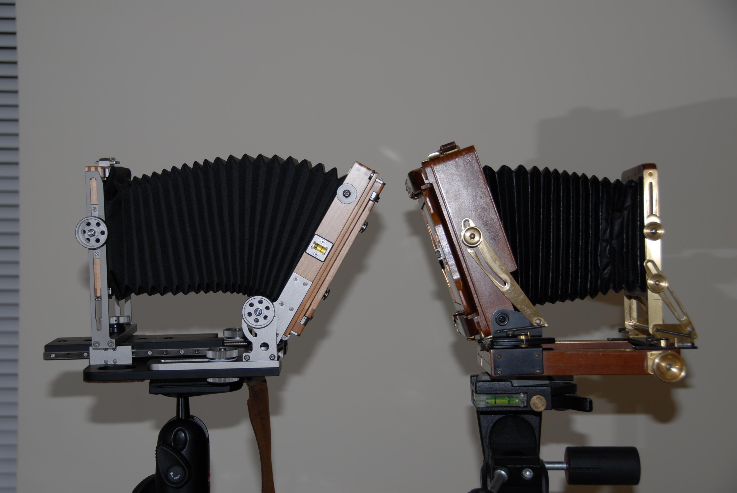

And here they are, opened (sans lens).
With the cameras open and ready to shoot, we can compare some aspects of each in practical use.

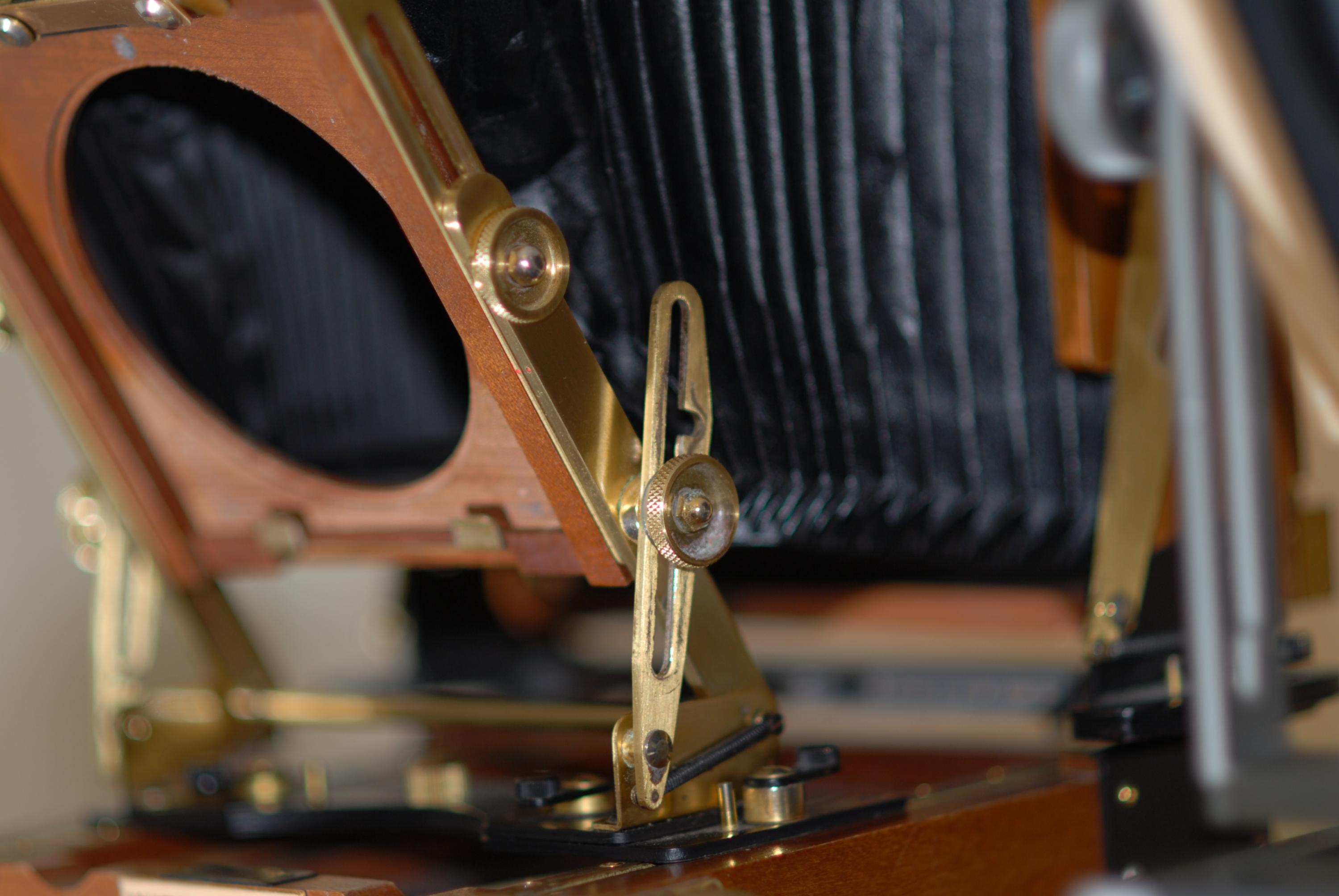

Here is a detailed shot of the Chamonix mechanism:
And the Wista mechanism:
The Wista uses a detent in the support to quickly find and lock the vertical position of tilt. One of the stated benefits of this is that one can slide the standard to the vertical position with little thought, and shoot without tightening the knob - the detent has sufficiently close tolerance to eliminate any unwanted motion.
The Chamonix uses two locking pins, located under the lens board holder, to secure the vertical position. The benefit of this design is the lack of any interference by a detent during tilt adjustments. The Wista must be restrained from falling into the detent when performing very small tilts by pressing the rail back with an extra finger, and then tightening the knob to keep the standard from falling back into the detent.

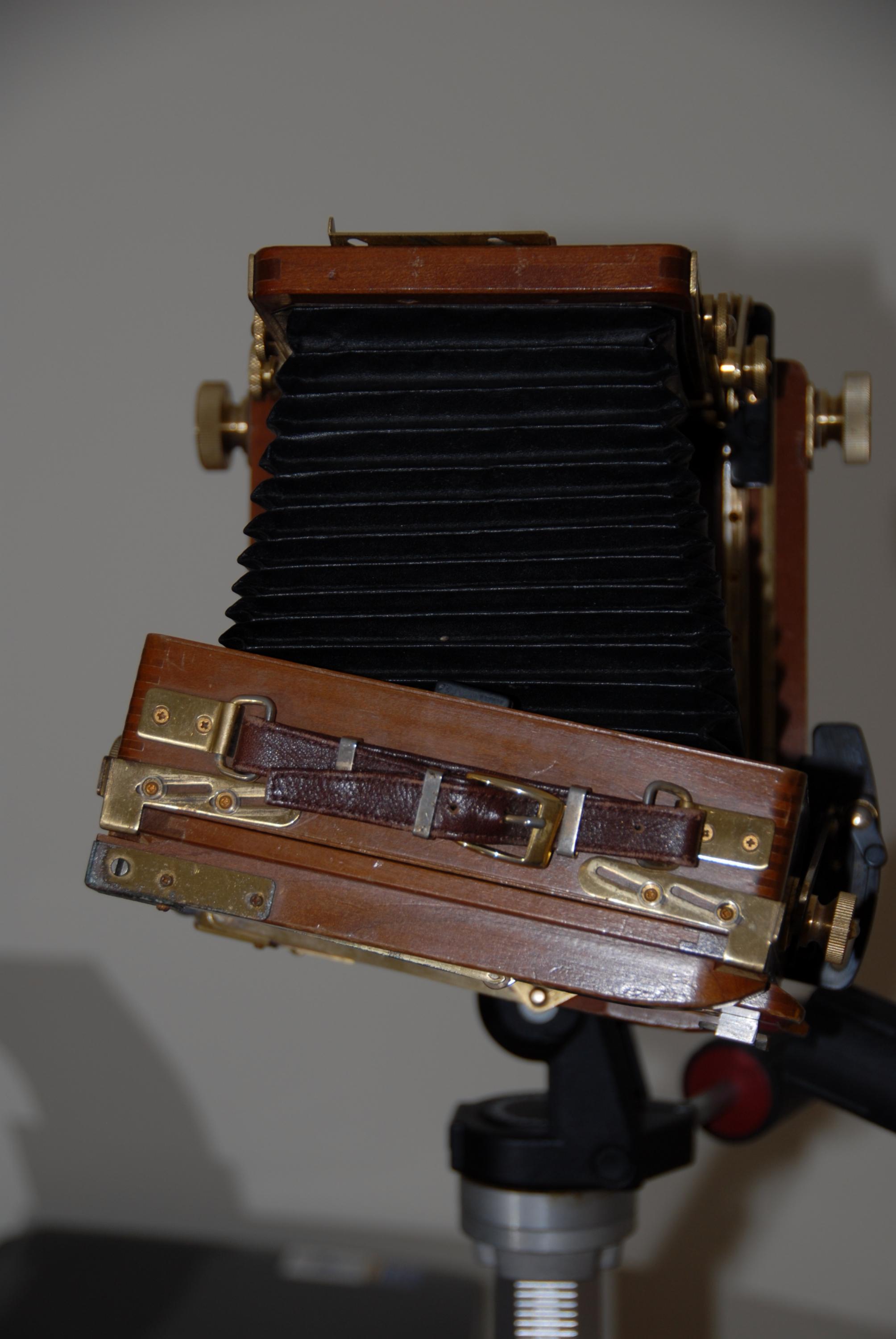

Back Tilt
Both cameras support back tilt. Both are limited on forward tilt by the bellows. Both are mechanically limited on back tilt. The Chamonix allows more back tilt, as can be seen in this photo comparing them:
(Astute observers will complain that I don't have the Wista fully back. The limit is not the track, but the bottom of the back itself. Look closely.)
The Wista uses a detent to lock the vertical position. This has the same benefits and drawbacks as the front tilt mechanism described above. The Chamonix has two sliding locks that stop the back in the vertical position. To me, this is a better solution for the same reasons described under front tilt.

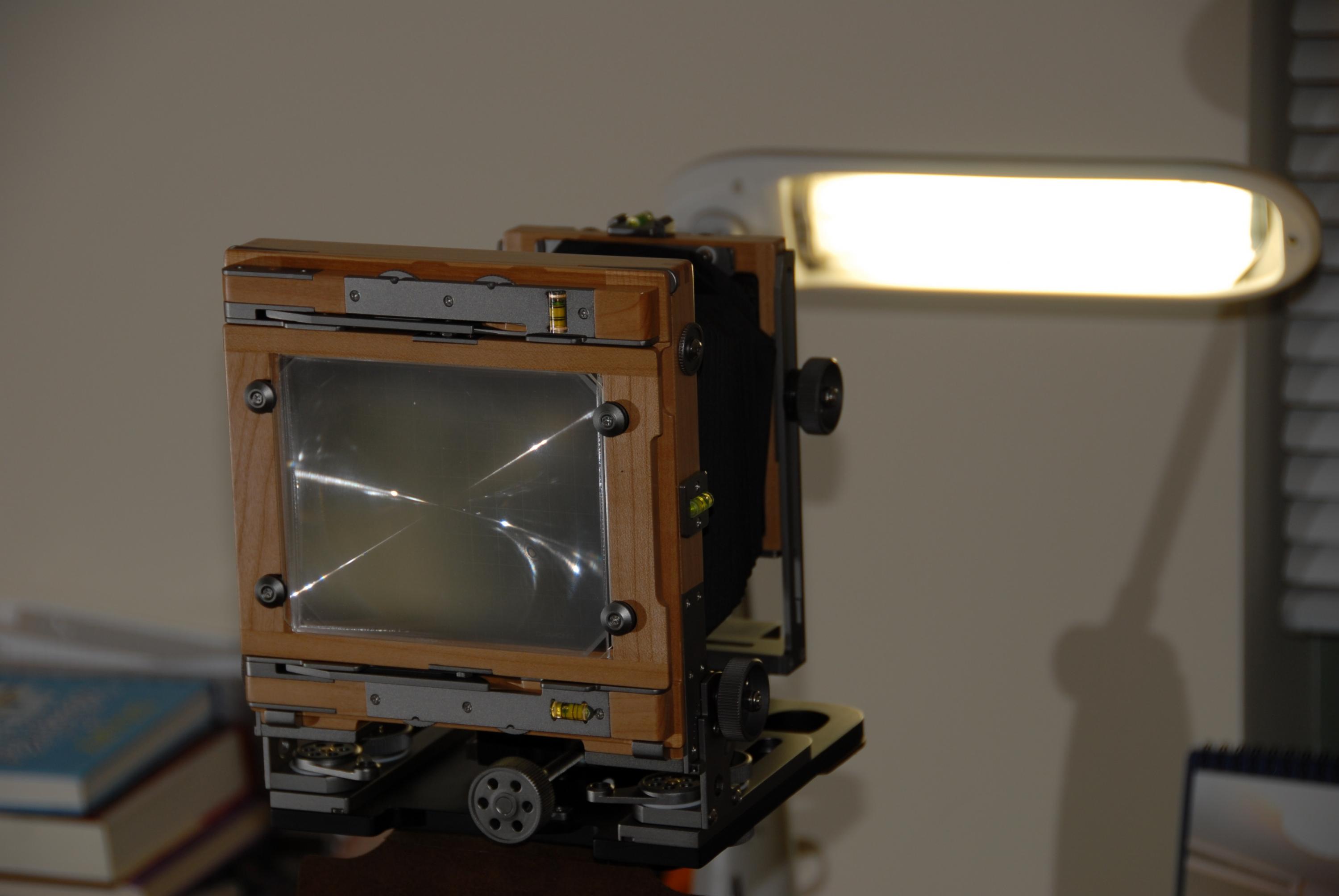

Ground Glass
Both cameras have ground glass with an integrated fresnel. The Wista appears to be a ground glass with integrated fresnel (on the back side away from the lens), with a clear sheet of protective cover. The Chamonix appears to be three layers - ground glass, behind which sits a fresnel, behind that a protective sheet. The final protective sheet is more reflective than the sheet on the Wista, and this could cause a problem if you focus without a cloth in bright sunlight.
The Wista has faint marks for what appears to be a 6x9 frame on the ground class, and also has a central non-fresnel area of about 23mm or so in diameter. Perhaps this is to address the wide format focusing issue that many reported with the original Chamonix ground glass. In fact, Wista does mention several ground glass offerings for the camera - different ones for wide, normal, and long lenses. I wonder which one I have?
I conducted a very unscientific test to see which glass was brighter. I shined a fluorescent light through both cameras, and metered from the back of each. I used my Minolta spot meter, set at ISO 100. The brightest reading of the direct bulb was EV 17.3. The brightest spot behind the Wista (in the non fresnel central spot) was 14.6, and the dimmest spot near the corner was slightly over EV 10.
The brightest spot behind the Chamonix (near the center) was EV 13.8 - measurably more dim. However, the dimmest spot was around EV 12, indicating the light was more consistent and brighter across the screen. I suspect the difference in the center was the missing fresnel area on the Wista, but I'm not sure. As I said, this is quite unscientific.

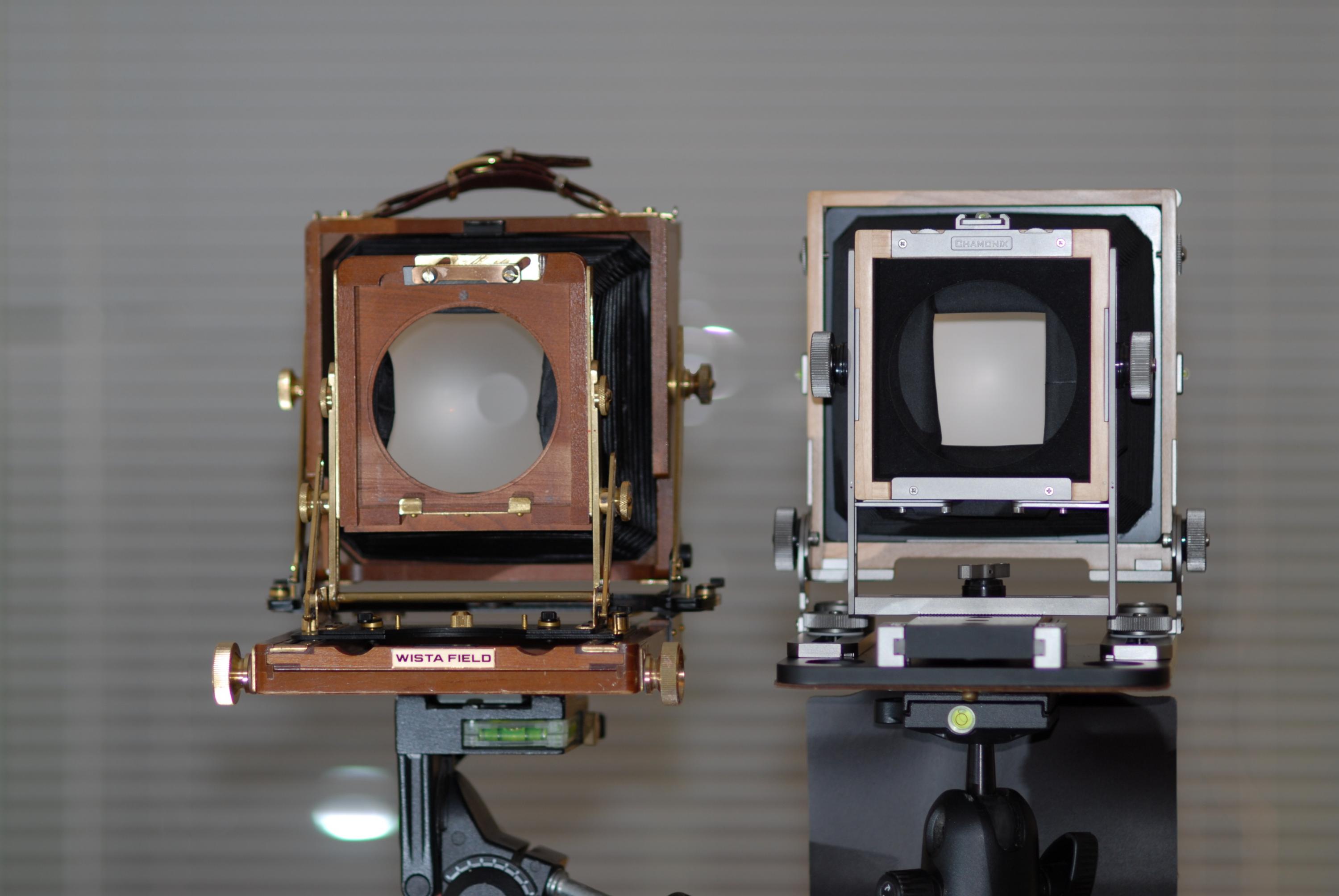

Alignment marks
The Wista has clear, bright red or white marks that stand out distinctly against the constrasting metal background. The Chamonix marks can be subtle, much more difficult to see on my model. I have gunmetal gray and maple, and the alignment marks are white. There is little contrast between these colors. The factory probably should consider a more contrasty scheme when building light colored cameras.
