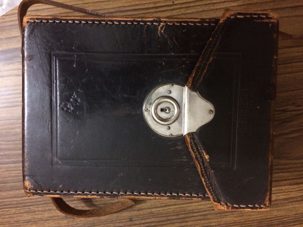

This was helpful, thanks. I received the camera today and I'm facing a beginners problem. I couldn't figure out how to unlock the case. Please see the attached figure. Any suggestions on how to open the case?
AgX
Apr 5, 2007
29,973
Germany
Yes, I myself once was puzzled by the same lock, on a folder's case...
You just have to slide the ring structure downwards.
(Unless it is locked, then you have to start lock-picking...)
