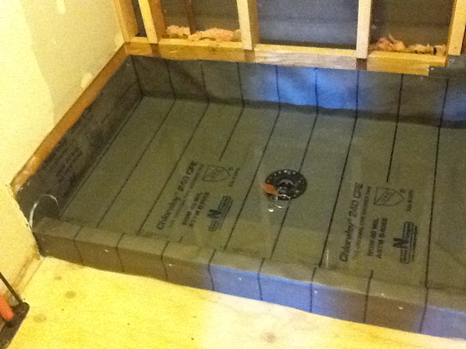

Why do you want to use ceramic tile? My second thought is that I’ve done ceramic shower pans which used a water proof membrane underneath the ceramic tile. So the answer is certainly yes you could build a ceramic tile sink that was completely water tight. Please excuse the poor cell phone picture as it is from about 10 years ago. Kind of hard to see but this is the 24 hour water test for my inspection.
You might also research fluid applied water proof membranes for ceramic tile applications. I’m not real familiar with these but I am seeing tile installers using these products.
Roger
I like that membrane for pans. Easy and effective.
There are several other different waterproof systems, mostly for shower walls: Kerdi, Durock, Hardie ... and paint-on barrier like red-guard or the blue alternative. Although not the best approach for a pan, I’ve seen water tests where they passed. For a sink, though... I’d consider Durock and Redguard.
a really good grout silicone sealant is recommended. Annual (or so) reapplication will prevent moisture seepage.
