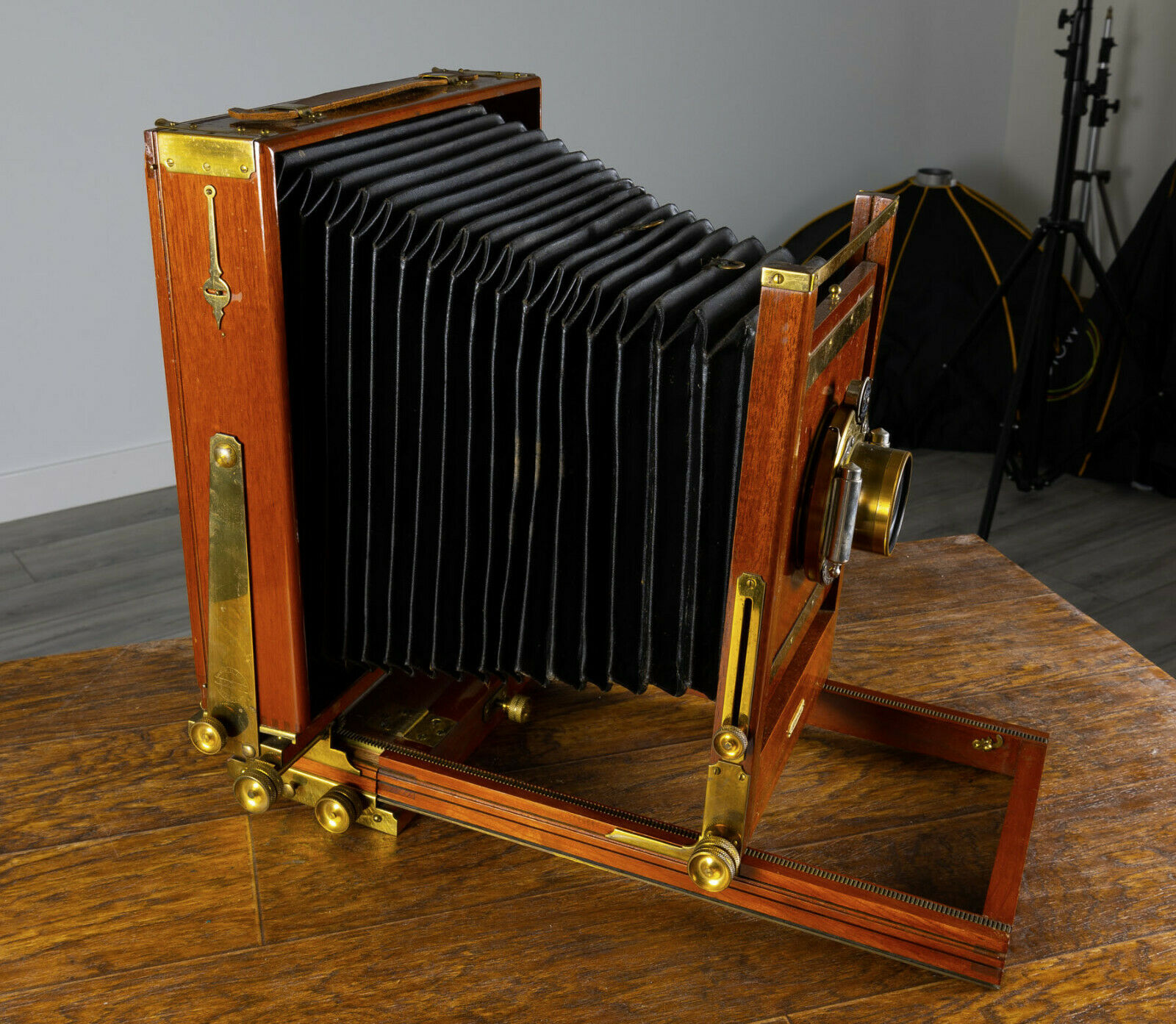

I recently acquired my first 8x10 camera, a beautiful circa 1900ish Century II perhaps?

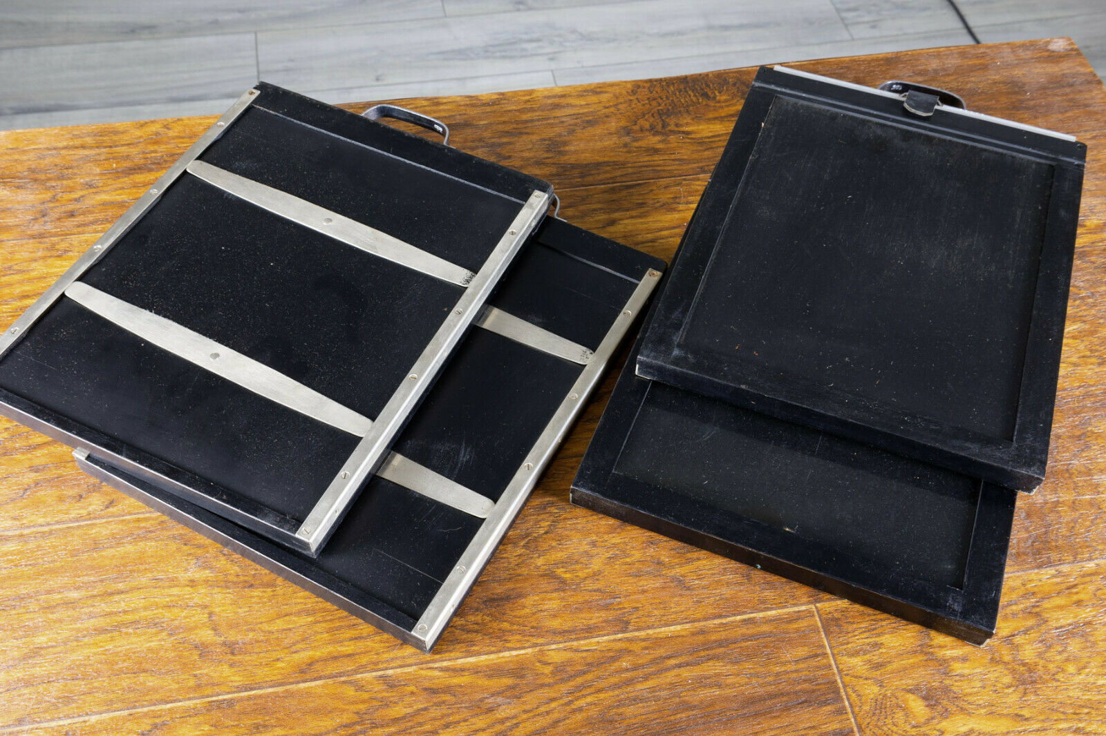

The camera came with 4 Folmer Graflex 8x10 "Pressure Film Holders". The prior owner left some 5x7 sheets in the holders pressed between the rubberized pressure back plate and the forward piece of glass that sits behind the dark slide.
The Pressure Film Holders seat well, held in place by the spring back/ground glass.
My questions are:
Was the camera designed to be a dry plate or film camera?
Do I need to buy conventional film holders or can I use the provided Pressure Film Holders to shoot film?
The provided Pressure Film Holders arrived with color sheet film pressed against a piece of glass. Is the glass a replacement for a wet or dry plate when shooting film with these holders? How are the Pressure Film Holders utilized when shooting film versus dry plates?
What back focusing issues are there when either shooting film or dry plate (assuming the camera was designed to shoot with the Pressure Film Holders)?
Lastly, the lens board measures approximately 5 3/4" square. Is this a standard size for 8x10? I want to buy a Linholf adapter board so I can mount my Nikon 300mm M f/9 and need to know if this is possible.
Any information regarding the camera, provided holders or lens board info is appreciated!

If I try shooting dry plates do I simply remove the glass?

How were these 8x10 pressure plate holders intended to be utilized? They have glass behind the dark slide. Is the glass for holding sheet film in place and you remove the glass if shooting your dry plates? My 4x5 plate holders have no glass inserts.

That would honestly be my guess. Easy enough to load a sheet of film on the glass and test focus. Remove the back, remove the glass, load a sheet of film, load the glass, close it all up and shoot.

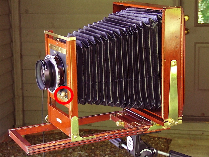

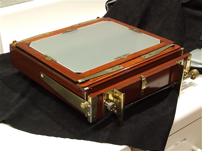

I added extra thumbscrew to hold the lensboard in place with a 300mm/5.6. It actually did fall off once, before the modification.
The GG back on mine accepts modern Lisco film holders. Yours looks similar.
