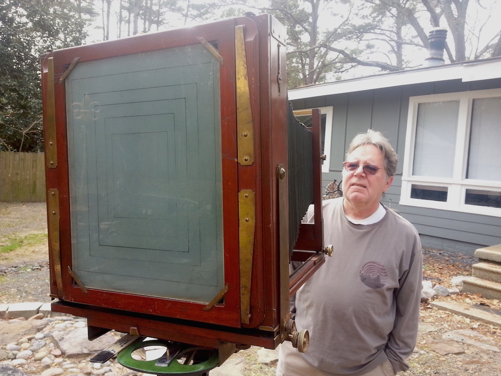

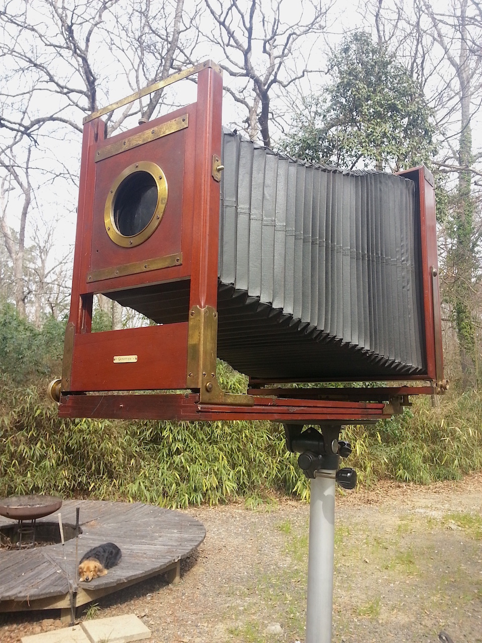

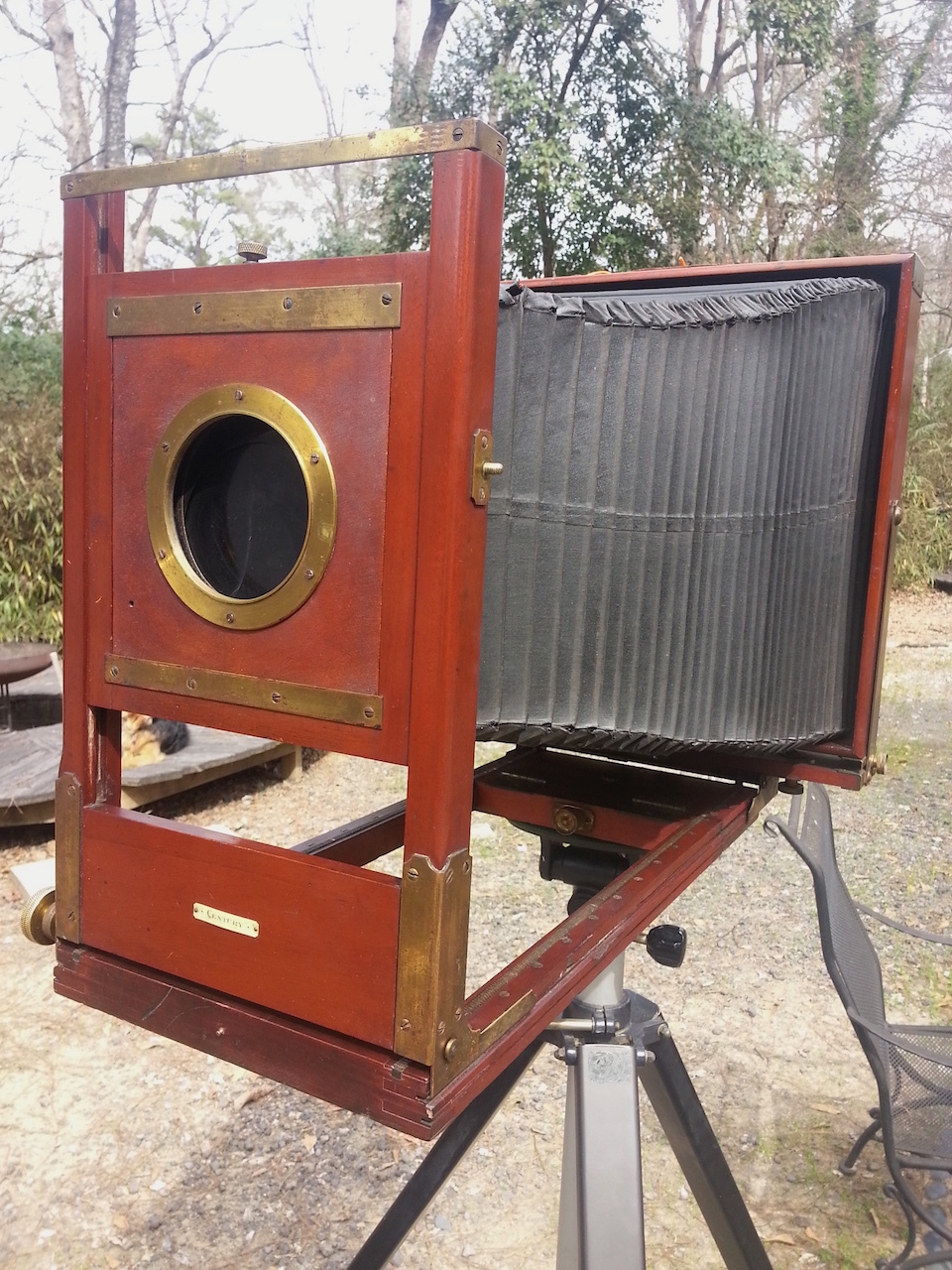

Just have a minute. Here are some pics I took this morning.
howellru
Jan 2, 2015
22
Having issues with uploading and have to run. I'll get pics up tonight
howellru
Jan 2, 2015
22
Let's try uploading these pics again.

After doing some research, it seems I have Century no.1 or no.2 View Camera from between 1902-1915. Here's a link on it.

It's a #1, note the lack of geared rise and the lack of the third slot on the rails for the sliding tripod block.

On page 52 of the 1903 Century Camera Company catalog http://piercevaubel.com/cam/catalogs/1903centurylp757.htm (previous link>catalogs) shows the Century View 5x7 at $20; 6 1/2 x 8 1/2 at $21; 8x10 at $24; and 11x14 at $35.
The main feature that yours is a View and not a View1 is the front standard does not have slots rise/fall but two knobs for pressure lock or tilt function. In your pictures your cameras front standard is missing a brass lock knob on the front standard which will detract from its value but otherwise appears to be in very good condition. The 1904 catalog shows the same Century View picture as well as pictures for the View 1 and View 2 but does not list the View in the pricing.
