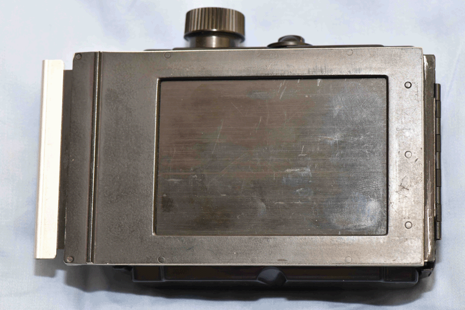

An update:
Picked up the camera today from the dealer. While not immaculate, it's extremely clean, and the shutter would only stay cocked intermittently. I found some naphtha, and applied a couple of drops to the slot where the cocking lever rides, after removing the lens elements. At first, it wouldn't stay cocked at all. I could see that some naphtha had migrated to the shutter blades, so I carefully dabbed the blades with a cotton ball until I couldn't see any more. It still wouldn't stay cocked, so i walked away, leaving the shutter to air dry. A few minutes ago, I tried the shutter again, and it's cocked 20 straight times, and the shutter speeds "sound" fairly close, compared to a Graphex. I'll let it dry overnight, and reassemble things.
Now, comes another question. I have a Graphic 23 back that I'd like to use. I removed the standard back, and the "23" back fits into place. I slid the levers to lock the back in place, but even though it fits, it will not lock; will easily slide to the right until it contacts the rangefinder tube. I've looked at this from every angle I can think of, but I don't see anything resembling a "lock" to keep the back from sliding. Any suggestions?
Do you mean the focus panel? Its the piece with the ground glass.
Does the Graphic 23 have both light blocking ribs? The inner one should seat into a grove in the back while the outer one should be just on the outside of the back edge.
The graflok sliders should just go over the outer lip edges of the Graphic 23.
Post pictures if you don't get it figured out.
Bingo! Looks like the left side rib has been removed, if ever there. Looks like it may have come from a 4x5 Graflex back assembly. Looks like I'm in the market for one that works. Thanks for the help. Much appreciated!

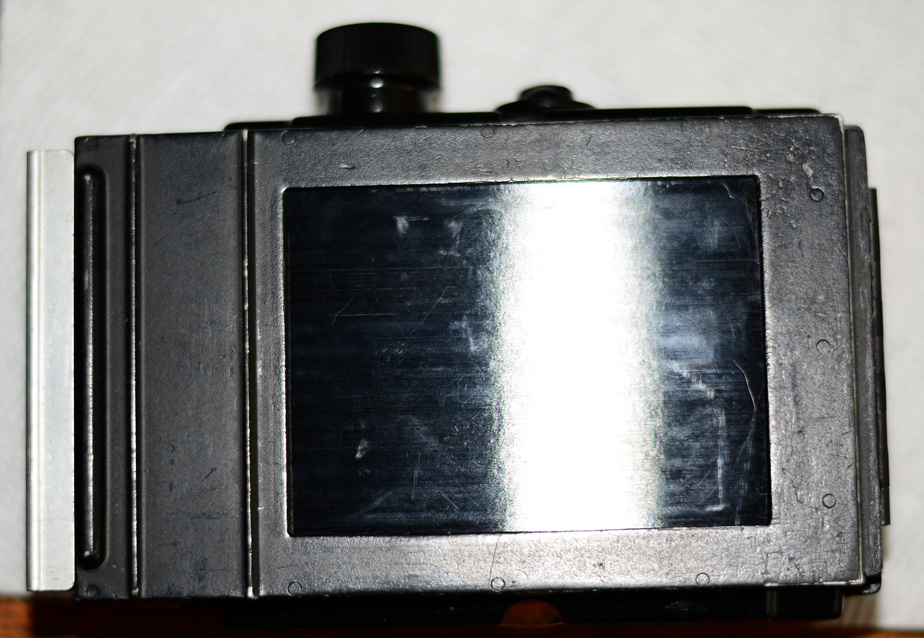

That matches my (known working, with my RB67) Graflex 22 back, and hopefully the 23 I have on the way (should get to me in the next few days). It also matches the Graflok interface parts of my three RB67 roll film holders.
To mount that to your Century, you'd remove the ground glass panel by lifting the two chromed levers and sliding to the right, put this roll holder in place (its rib will drop into the matching groove on the camera back), and slide the two chrome tabs so they tighten into the edge grooves on the upper and lower edges of the roll holder.

That's an early manufacture roll film holder. This is a later version:
The progression was addition of the second rib, pin rollers, then the lever wind. I do not know the dates, pin rollers in the mid 1960's and the lever wind in the late 1960's. The second rib likely came into being in the late 1940's or early 1950's.
