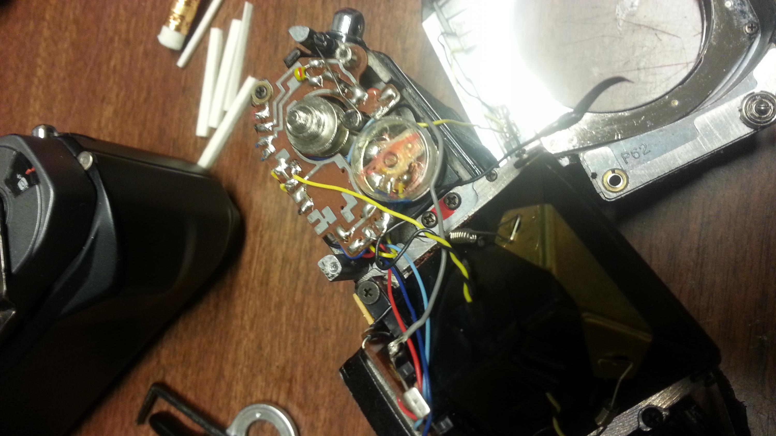

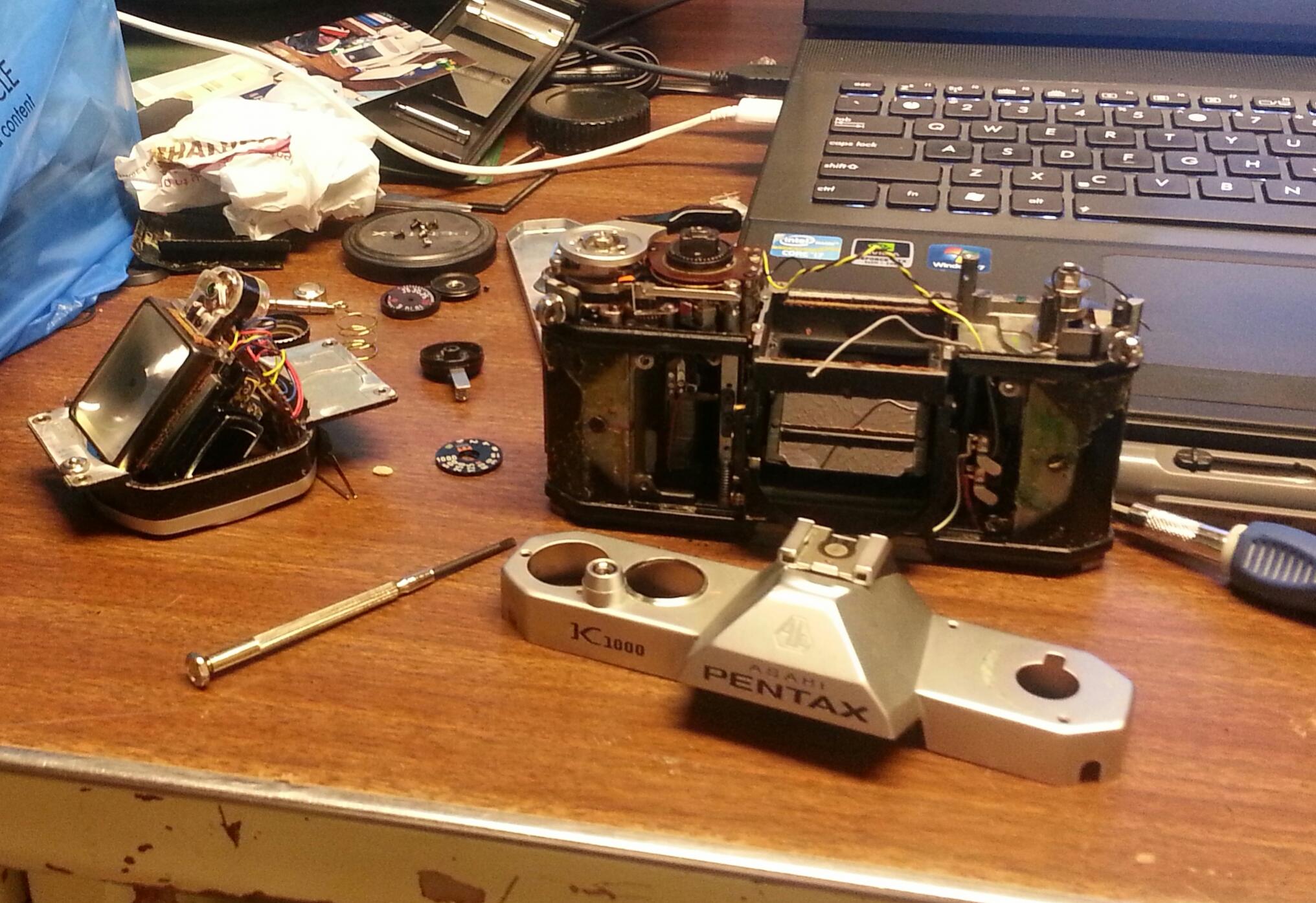

Jun 4, 2013
33
The carbon surface of the diaphragm resistor is flaking off and is probably resulting in an open circuit. This is common with age among K-1000s. If adjusting your aperture has no effect on the meter, this is the problem. 20130503_000957.jpg.noexif-1-1992331493.jpg20130505_232345.jpg.noexif1785073421.jpg -pictures added to show how I learned that.
