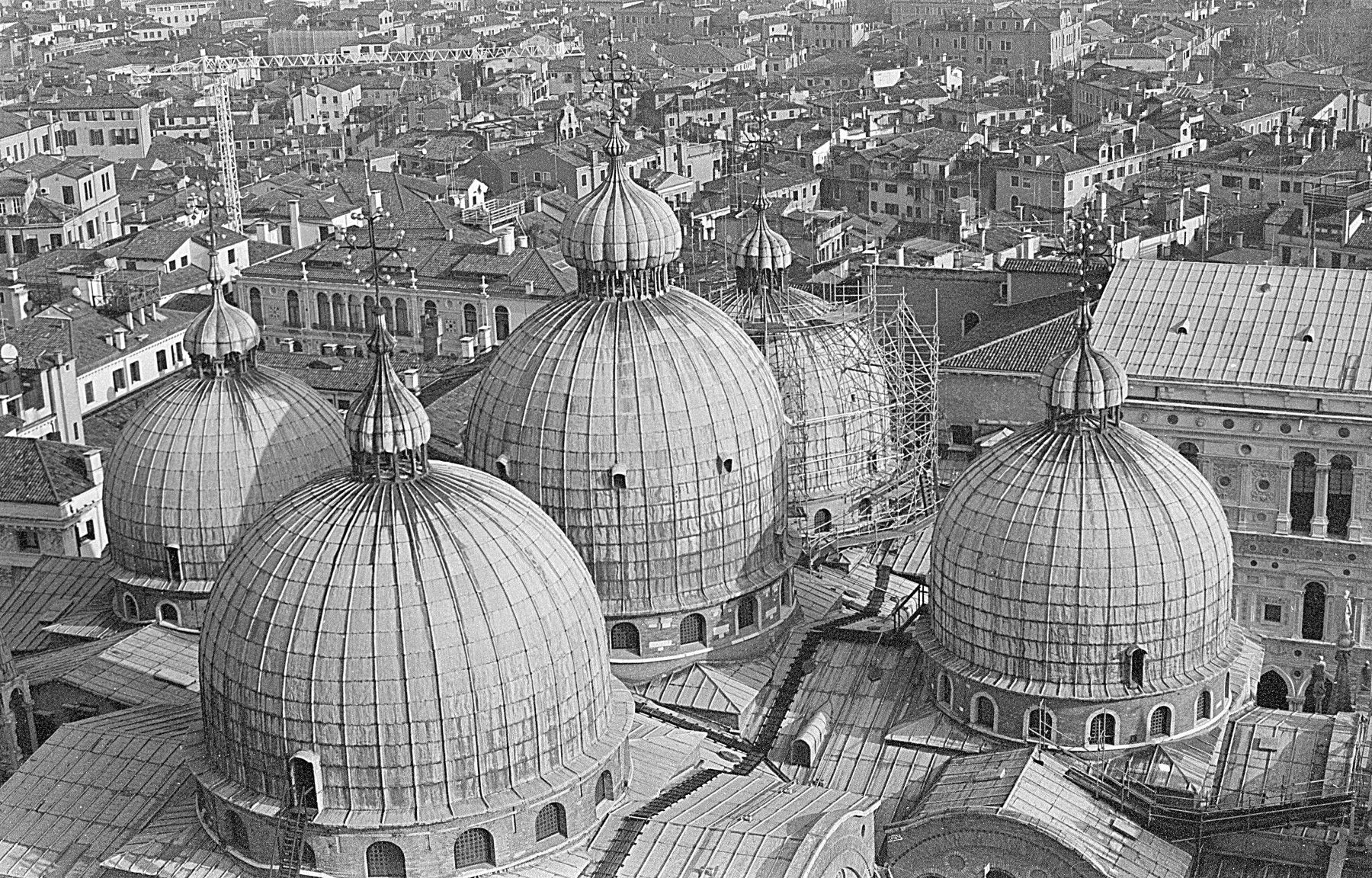

I have been mulling practical options to remove remjet without having to take either poison. Here is one in I just came up yesterday. How about an ultrasonic cleaner, like those small ones for jewelry cleaning as long as it can hold a single film reel inside. The softened carbon deposit should come off easily without any physical scratch. If anyone happens to have one at home, would you please give it a try and let us know if it works?
The bright side of my planning is that finally I got a dedicated film scanner for ecn-2 negative. :smile: I don't have a real color sample yet, but here is a b&w one (fuji400 in 510-pyro).

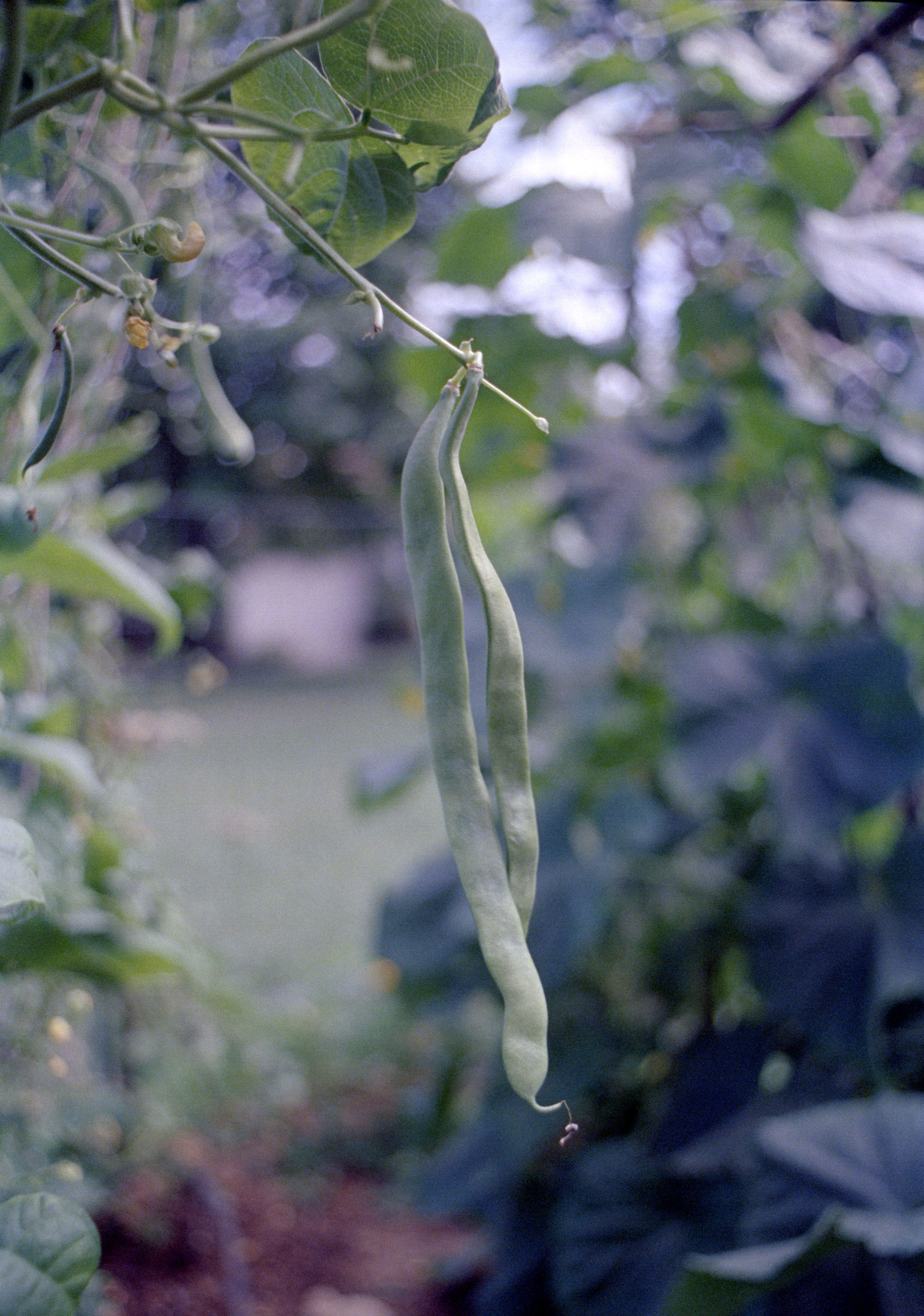

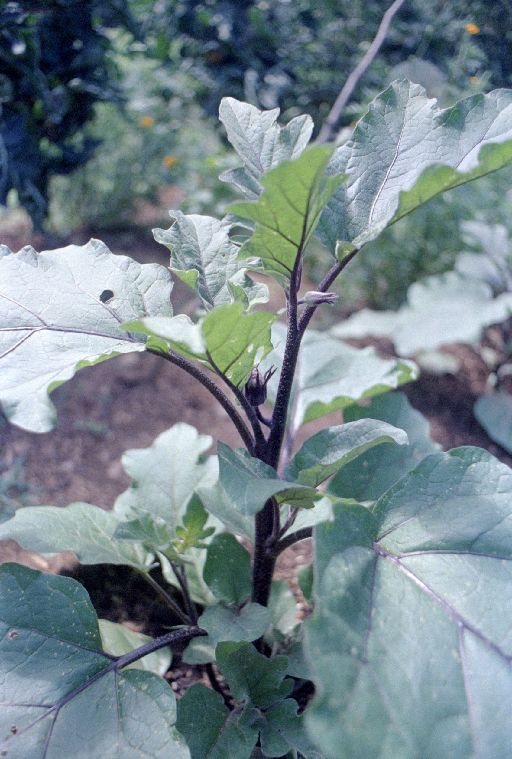

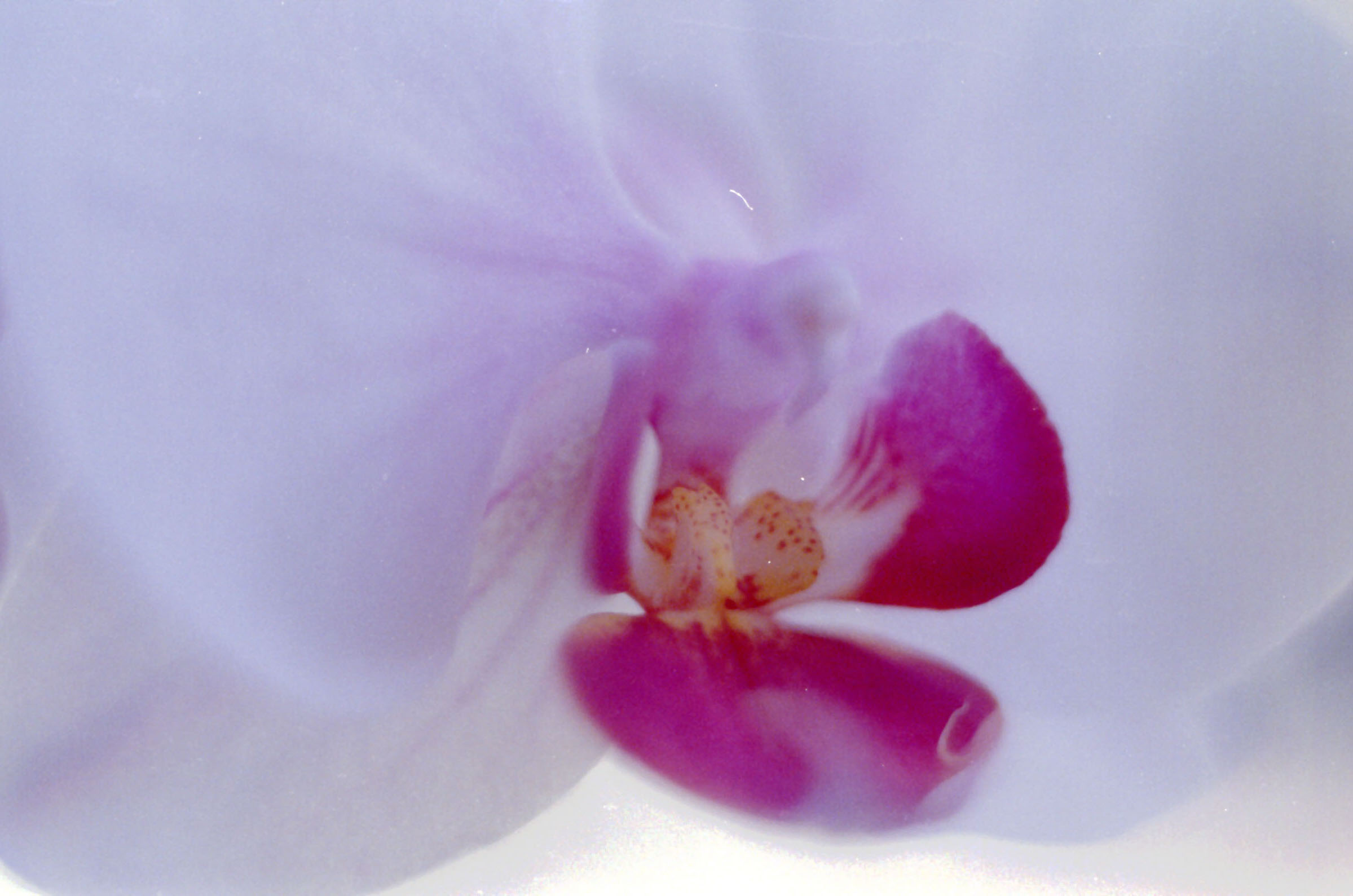

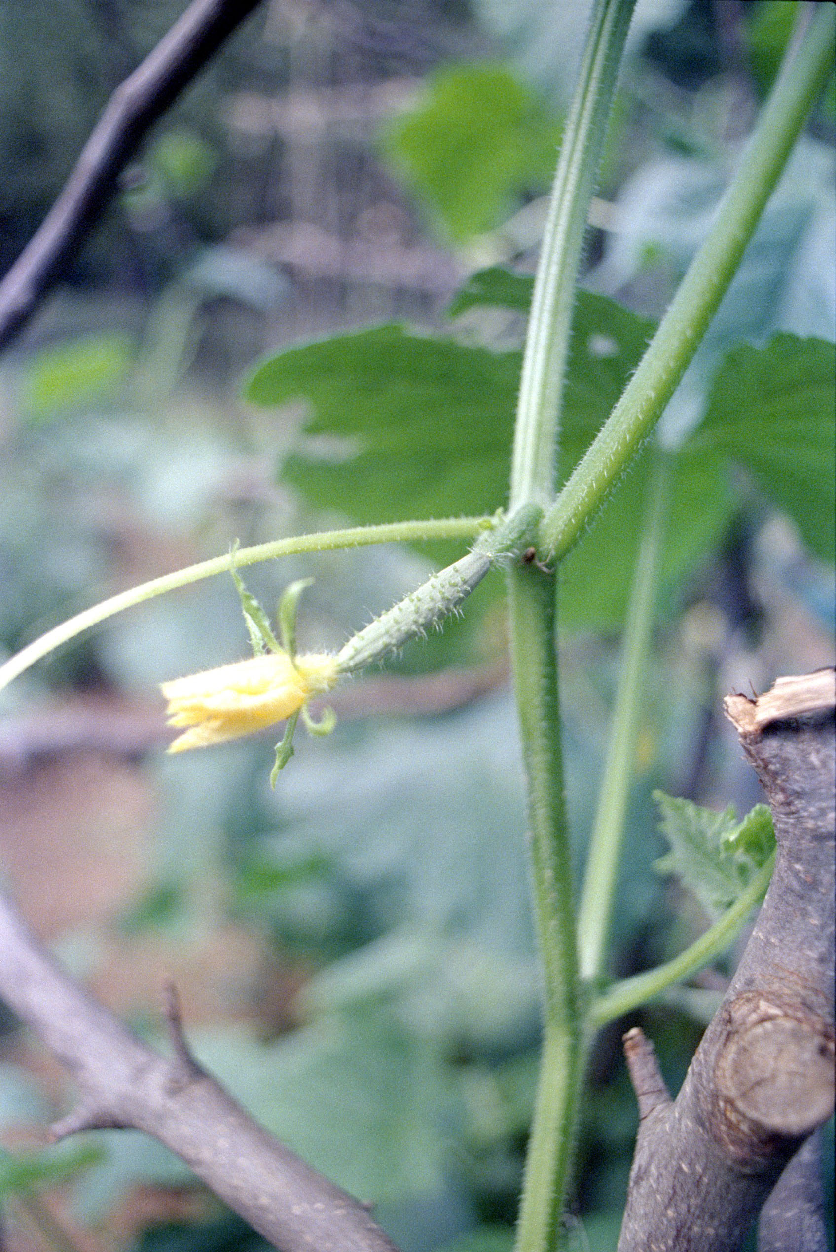

Finally I got chance to develop my first roll of color film in my life via ECN-2 process as published by Kodak using CD-3. I did make a mistake by overdeveloping the film a little bit (time & agitation). The temperature control is not too bad in a water bath and it does take time however. I only rinsed rem-jet 3 times after pre-bath and didn't wait until the water became totally clear. So there are a few visible specks in the scan (Mädchen Orchid). The ICE was on for the other three (Lady Eggplant, Mr. Bean and Baby Cucumber) and the rem-jet specks are significantly reduced if not totally eliminated. There is no other post-processing except for image rotation, size scaling and a little cropping.
