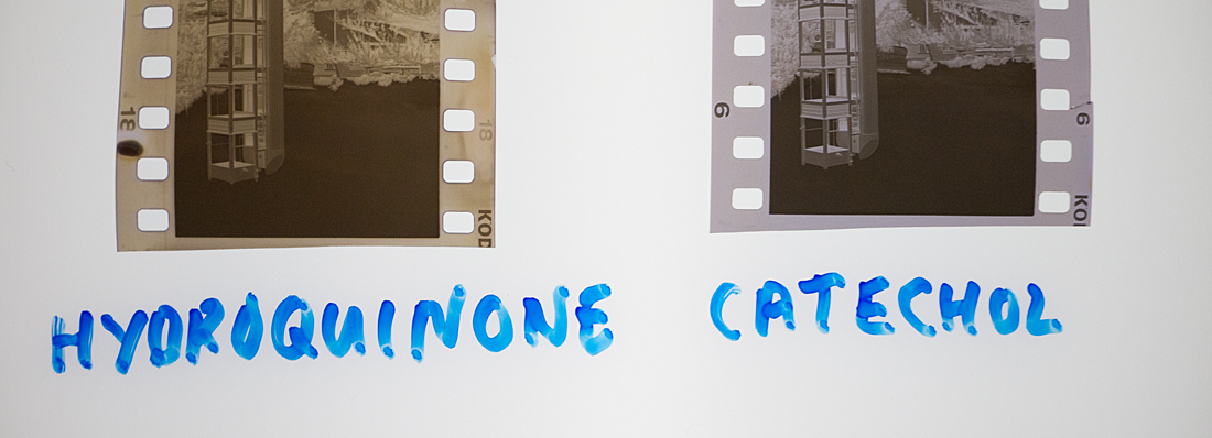

I used Obsidian Aqua-type with the specified catechol vs the same with catechol replaced by hydroquinone.
Demin water.........................40ml
Sodium metabisulfite.............0.2g
Catechol (or hydroquinone)....2.5g
Demin water to.....................50ml
Dilute 1:100 with 6.7g/L Potassium Carbonate solution.
Develop Tri-X (spare 2008 date) 12min 20C Agitate 10s/min
Attachment shows both catechol and hydroquinone produce stain.
Bleaching and fixing a negative from the hydroquinone developer showed a relief image indicating tanning.
Prints were made from scans processed identically.
(1) Neither was particularly fine grain
(2) Hydroquinone gives more grain and less sharpness than catechol.
This one experiment provisionally suggests that (2) is the reason why catechol is used in preference to hydroquinone in practice.
It is also a lot more soluble than hydroquinone.

I am puzzled by the picture of the negatives. Since these are the same type of film, and the brown colour on the HQ sample is visible everywhere (ie including unexposed areas), if that is indeed HQ stain there appears to be a high level of non-imagewise stain/fog stain on that sample. I'd also suggest using fresh film for these kinds of tests.
Another way of interpreting this is to propose that hydroquinone requires a higher sulfite content than catechol to prevent overall non-image stain. This is the value of keeping all but one variable constant in a series of experiments.
It would be interesting to see a series of experiments where the amount of sulfite is increased until the overall stain no longer occurs. This of course would also reduce the amount of image stain. This would be in line with what Michael and I have said that hydroquinone produces less image stain than catechol.

The oxidation colour of Hydroquinone in a developer is a reddish Brown, Pyrocatechin - Blue/Green. When I use IT-8 toner if the re-developer has turned blue-green then it stains the emulsion, and paper base with FB papers. IT-8 gives olive warm tones.

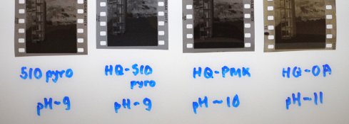

Looking for fine grain, the lower pH HQ-510 Pyro was tested vs 510 Pyro, using the same 2008 expired Tri-X.
HQ-510 Pyro
Triethanolamine................85ml
Ascorbic Acid......................5g
Hydroquinone....................10g
Phenidone.........................0.25g
Triethanolamine to.............100ml
This was heated to 200F in a stainless steel pot on a hotplate using a meat thermometer and stirring with a spoon.
Caution, flammable.
Dilute 1:100 for use.
Time required to develop in HQ-510 Pyro was about double that for 510 Pyro.
The grain was not quite as fine as that obtained using 510 Pyro itself and barely distinguishable from HQ-PMK Pyro.
Attachment shows the stain using HQ decreased with falling pH.
510 Pyro itself gave the finest grain of the combinations tested. This may be because the pyrogallol still stains at the pH of TEA.
All staining developers that I know of show a combination of general stain (everywhere) and image stain (proportional to the image density). Here, the general stain for the hydroquinone developer is more apparent. But the stain is dependent on a number of things, including pH and sulfite concentration, and is different for different developing agents.

Results for the relief image (tanning) after I bleached and fixed the negatives:
OA type .........(Catechol-carbonate)................strong relief image.........pH~11
HQ-OA type..., (Hydroquinone-carbonate).........moderate......................pH~11
HQ-PMK..........(Hydroquinone-metaborate).......faint.............................pH~10
510 Pyro.........(Pyrocatechin-TEA)..................moderate to strong..........pH~9
HQ-510 Pyro....(Hydroquinone-TEA).................none detected.................pH~9
Conclusion-Hydroquinone tans less than Catechol at pH~11 and the degree of hydroquinone tanning falls with pH till not detected at pH ~9.
510 Pyro itself still tans quite strongly at pH ~9.
