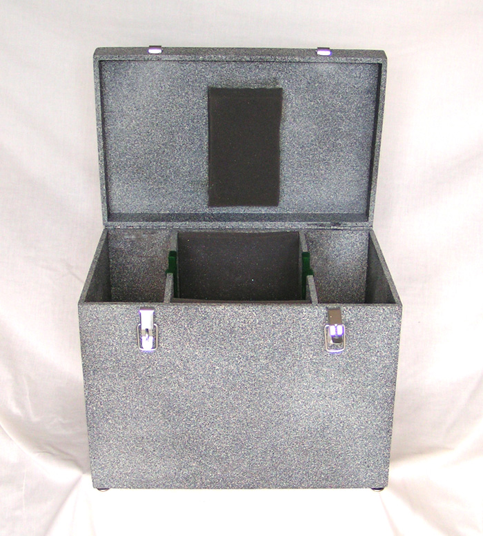

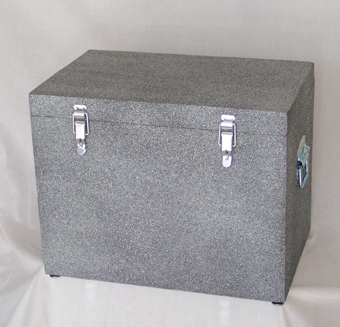

I don't know that there is an easy way to transport a monorail view camera. For the first month after I got my 4x5 Omega E model I carried it on the back seat of the car and tried to be very careful. Then I built a case for it and bought a small folding luggage carrier. The camera is safe and the carrier has wheels which has allowed me to take it pretty much where I wanted to go.

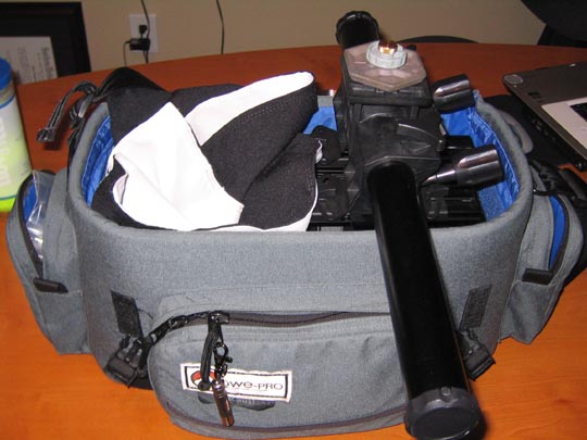

I use a rectangular lowepro shoulder bag to carry mine. I push both standards to one end and the end with the standards goes into the bag and the rail goes away from by body. I still have half the bag available for all the other goodies that go along with LF photography.
