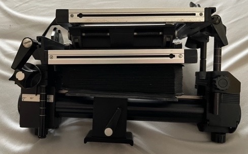

With a Sinar, you can pack it more compactly by unlatching the bellows from one standard and either swinging the standards 90 degrees to be parallel to the rail, or tilting the standards down onto the rail. Here's a photo of an Alpina packed the first way into its original plastic case: https://cameraexc.com/products/sinar-alpina-4x5-camera-in-case-1 However that case doesn't hold anything else.

Your photo of the F2 folded shows something other than the standard rail clamp?
Of course the standard rail clamp could be turned sideways for packing.

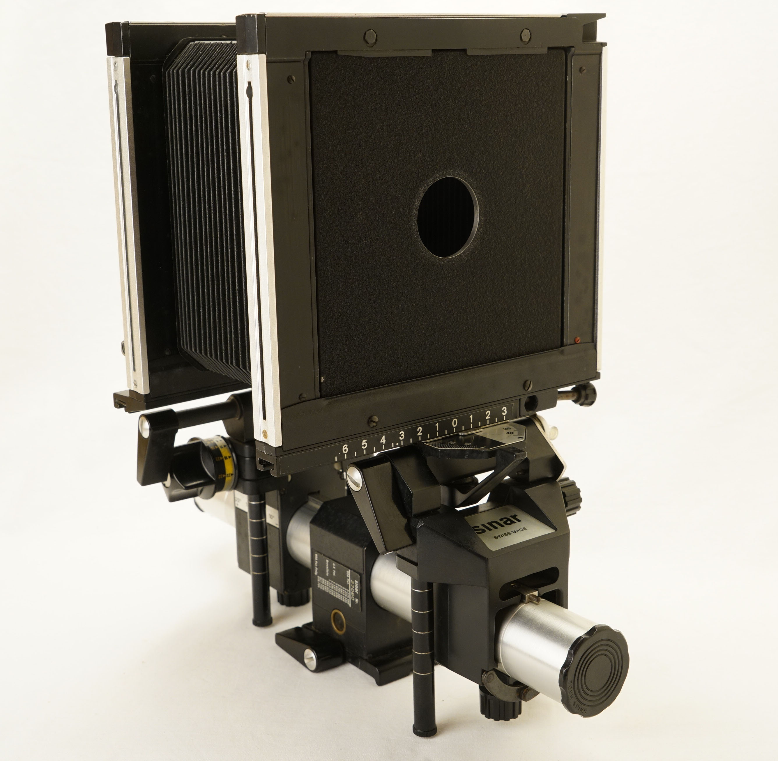

That's an Alpina - basically an F1 with with a special lightweight rectangular rail, not a conventional Sinar with a round rail and its own kind or rail clamp. The F2 would be difficult to compact in the same manner due to its longer standard rods. A longer than standard bellows would also be a challenge. But there are other ways of doing it compactly if necessary. I prefer to use a backpack with the camera fully set up, needing only to place it on the tripod, extend the bellows, and then go to work.
nah, its a F with a round rail (in this case a black rail from a later F2 or P2) There were several versions of the rail clamp, this one is shorter than the more common one. I like that because height=leverage.

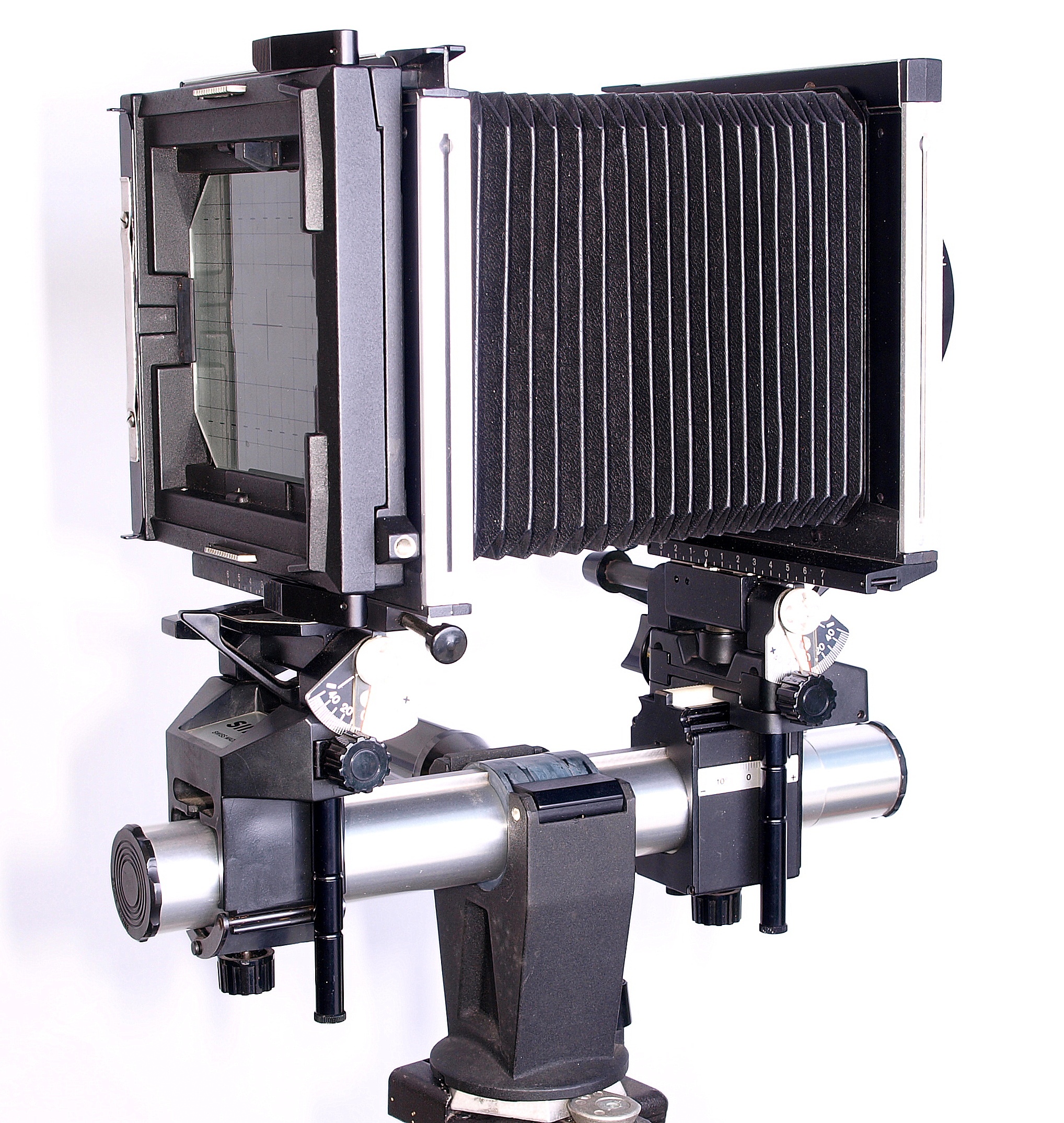

Oh, I guess it was the reflection atop a black or underexposed rail that made it look channel-shaped to me, like an Alpina rail, on my screen.
My favorite rail clamp is the old Norma version, like in the last picture, due to its lower profile. It works for any of their conventional rail sections.
The second picture is a chimera, with the rear standard being the front standard to the old F+,
installed backwards, which is actually an inferior "intermediate bellows standard". Works OK, but not as durable in the long run.
Ha! I didn't notice. Someone who liked his knobs on the left side, and liked focus on the front standard, not the rear just swapped lens board and film back! It kind of shows the danger and flexibility of the Sinar system--they're so interchangable and flexible you can build exactly what you want, but when you're buying you might get a frankenstein machine if you don't look closely. When I bought my 5x7 Norma, the seller noted that the knob on the front standard was on the wrong side. Turns out the the front frame was mounted on a rear carrier, so it worked but you had had the knobs on the wrong side. I eventually found a correct carrier and replaced it to get the knobs correct, but then it turned out the carrier I removed was in better condition than the original rear, so I swapped that one too.
Well, I've swapped around all kinds of components depending on the specific application. And that is a great asset to the overall system. But it also has a darker side when someone cobbles together loose ends and tries to sell them as a particular Sinar model which it really isn't - not necessarily deliberately, but sometimes deceptively, for sake of a higher asking price.
