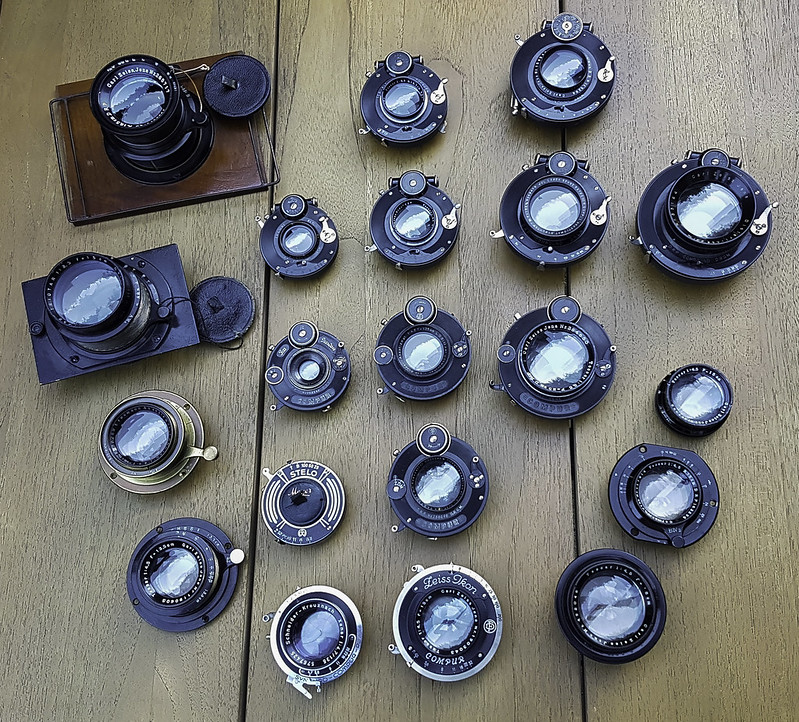

Have one (in below picture 2nd one on the left on the black plate); its a triplet and it covers 9x12 cm plates, and therefore should also cover 5x4 inch plates; it doesn't cover 13x18 cm plates and 5x7 inch plates.
Vintage German lenses by Ron (Netherlands), on Flickr
Look for lenses as from 18cm but preferably as from 21cm (e.g. the Carl Zeiss Tessar f 4,5 21cm; like the first one on the right side of the picture)

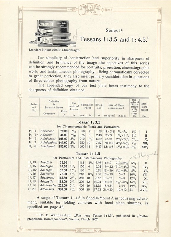

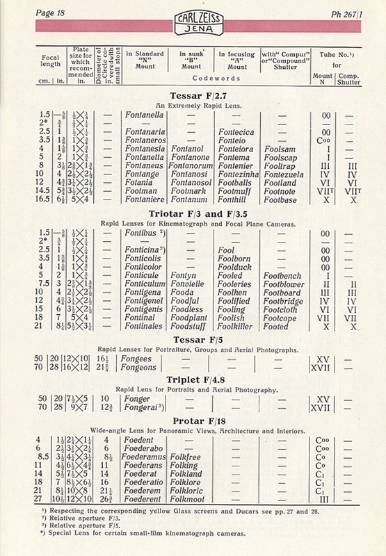

Thanks and very welcome....here is some additional info on the Triotar and other Zeiss lenses from one of the Zeiss catalogues:
and an other page on different Tessar lenses:
So here you can read that even a 21cm f3,5 Triotar doesn't cover 7x5inch plates whereas the f4,5 Tessar does cover....

Ron: really like the use of codewords in the old Zeiss data sheets😃 Thanks for posting.
choiliefan
Dec 27, 2013
1,306
Those code words were used to simplify when ordering goods by cable, or so I've read.

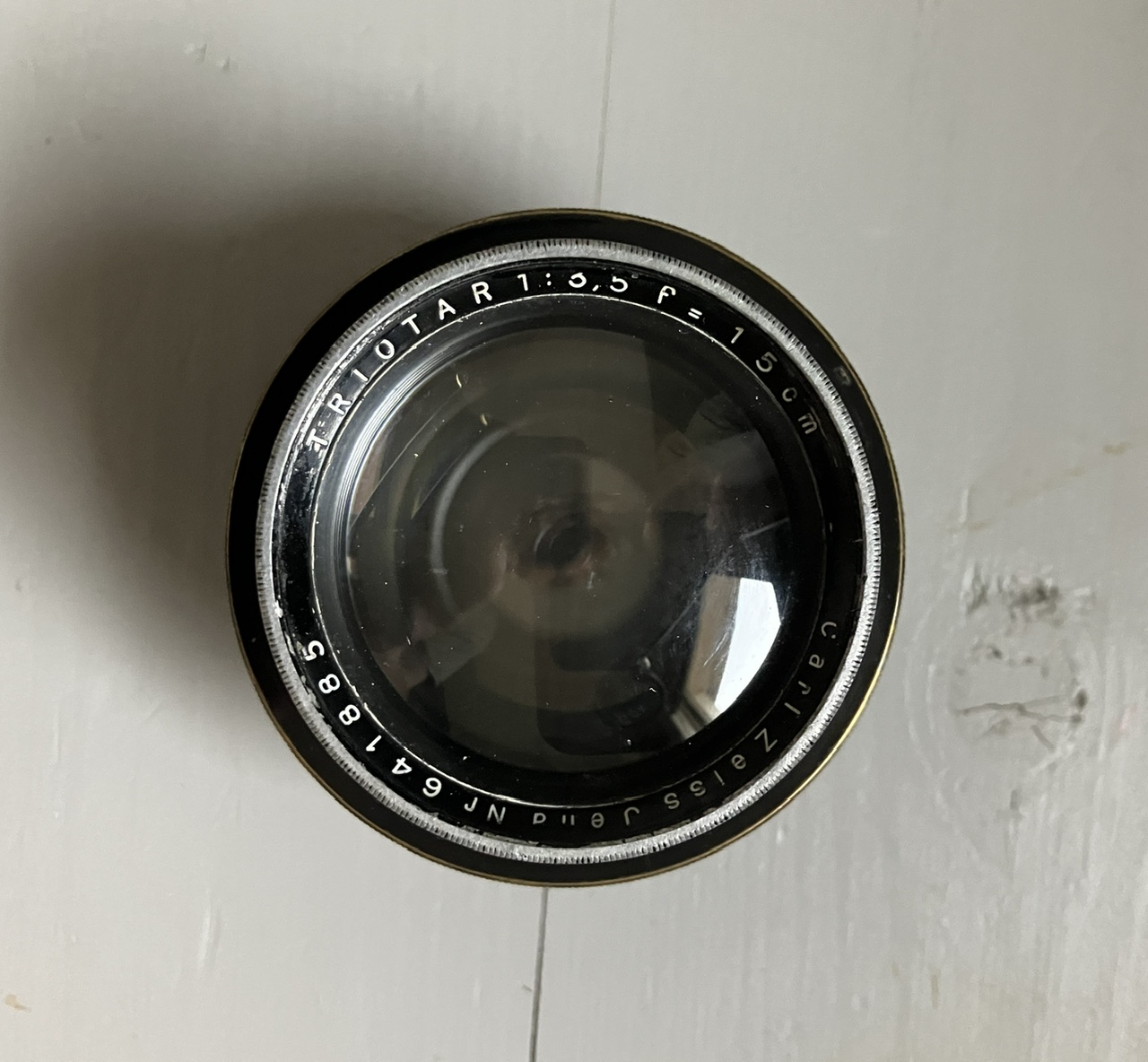

I bought a Triotar 15cm f/3.5 and will try it for 4x5 collodion wet plate portraits. It is a heavy used lens but lens elements are in good condition. I got it for 88 euros so it is worth a try.
Two questions.
Ron: can you identify the year of manufacturing using the serial number?
Is it safe to use isopropyl alcohol for cleaning the outer lens surfaces? Not sure if the lens is coated but I might see some blue reflections in strong light.
