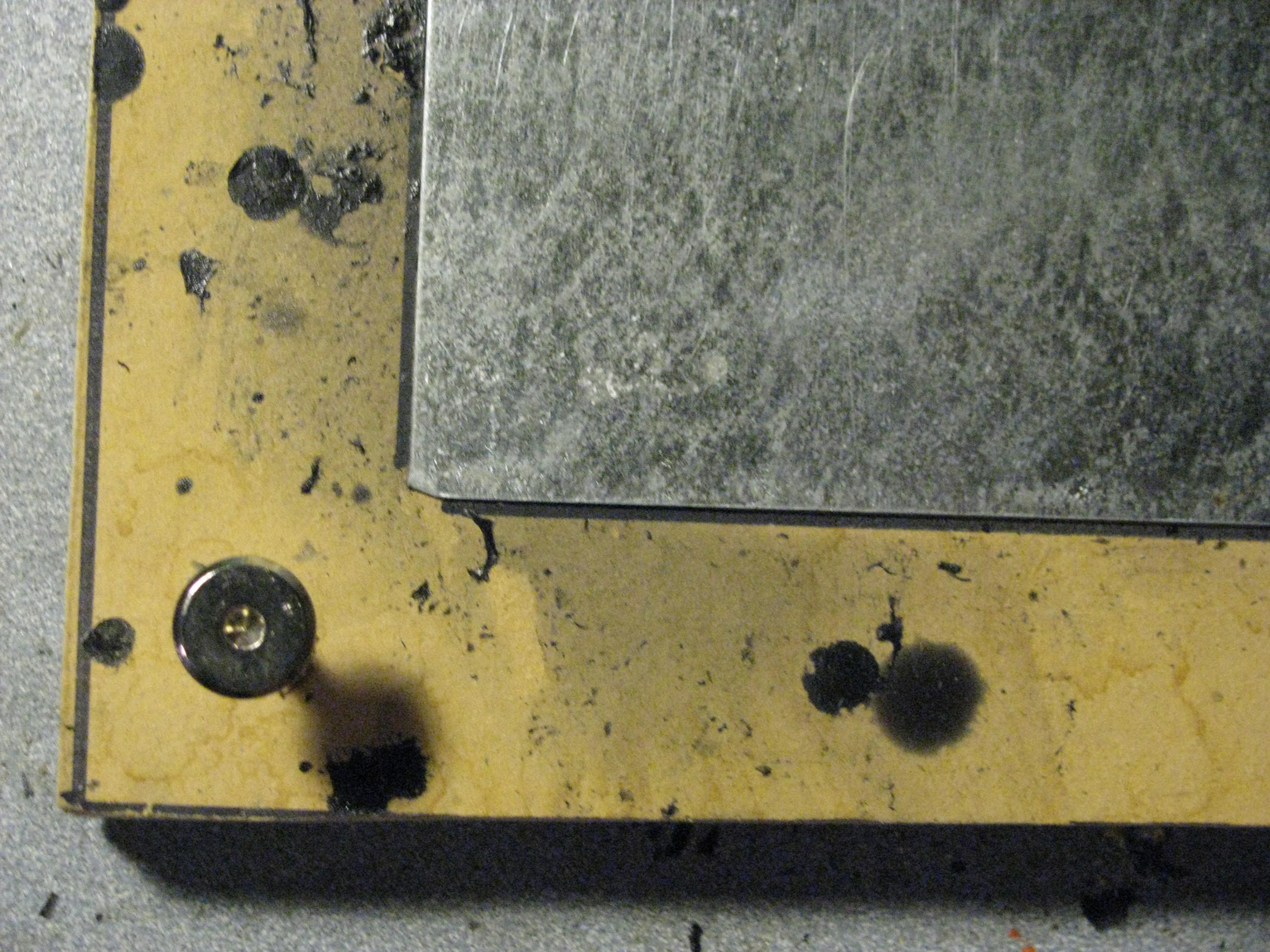

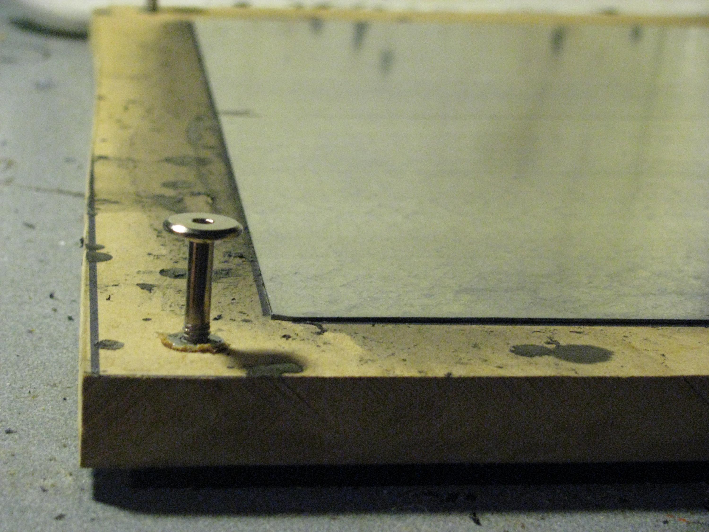

It's tough to see in the video, but could you describe your "pouring station" a bit? How thick is the steel? What is the base material? How is it attached?

Hi gmikol, I have two stations for pouring tissue. With this system, I can pour 20, 9x11 tissues in about 1.5 hours. The base is 3/4 masonite. I glued (contact cement) galvonized steel sheeting on top of the masonite. You can see in the pics roughly its thickness. I stuck in metal screws on each corner to aid in leveling. Hope this helps!
