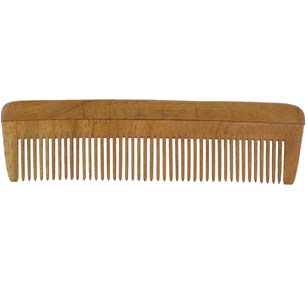

I draw the right size (square or rectangle) with pencil on the transfer paper (like Yupo) then pour the liquid carbon tissue inside this frame and distribute it further with a fine comb. It's very easy this way to divide the emulsion evenly and without spilling over the borders. But don't fuss too long for when the emulsion cools down too much you'll make tears with the comb. Just divide it fluently and even within 30 seconds or so. I start by making the borders with the comb and then filling in the gaps. You could practice using the comb with thick coffee milk first.

I keep it simple. Magnets and a Finger. Used to use a comb but too many of the teeth fell off. Finger works fine. This works well even for very large tissue (16x20). You don't need those rods, in my opinion. Rather spend that money on film... :smile:

I only saw striation marks made with comb if the temperature of the glop got too low. The comb doesn't need touch the substrate anyways.
