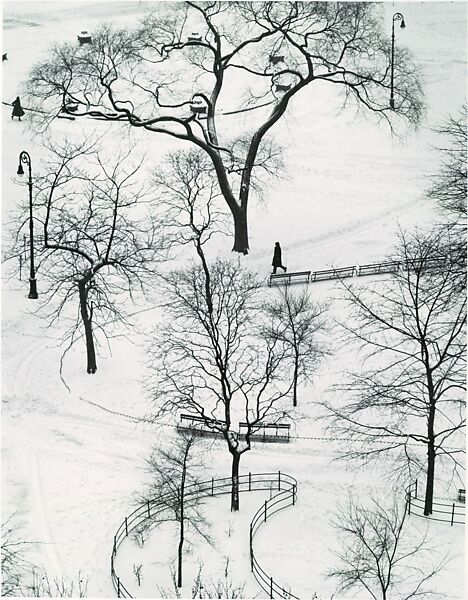

Snow allows for simplicity of image in black and white. Just look at this superb composition from Andre Kertesz:-

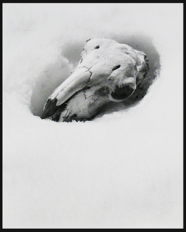

I shared this in a Christmas Card several years ago:
Vaughn
Dec 13, 2006
10,275
Humboldt Co.
Skull and snow in the sun. Photographed as found. 4x5/150mm lens. I metered the darkest area deep in eye socket, that set my exposure (f64 @ 1/4 sec, TMax100, that's an extra stop of light given for bellow extension and it felt right.) With all that light bouncing around, the socket read 14 and the snow only at 18. Not a contrasty scene and I gave it normal development (probably HC-110). 16x20 silver gelatin print, Grade 3 Gallerie, selenium toned. Enough detail/texture in the highlights to give the feeling of the topography on the surface of the snow, which was about a stop brighter than the sun coming off the skull. One of my favorite prints.
