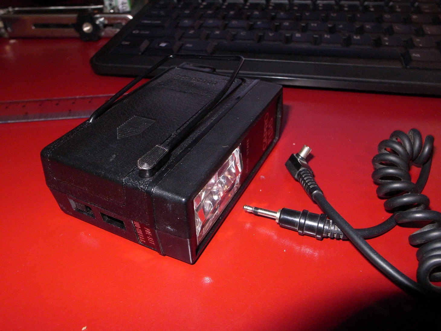

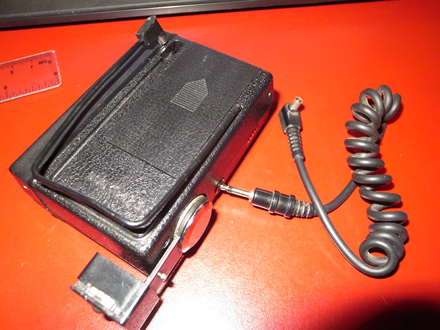

Another question: This flash comes with a 2.5mm jack to male flash PC sync cord (with coiled cord). There's another sync cord attached to the flash that plugs into the flash or into the camera. What is this extra cord for? I can't get it to work any which way I hook it up. The attached cord has to go into the camera to work.

It looks light it's supposed to have a hot shoe. Does it have a small socket next to the pivot for the shoe? If it does, try plugging the attached cord into that.
The cord connected to the flash has to be plugged into it's socket(if it has one) and the coiled cord fits a switch that bypasses the 1st one(you figured that one out).

I was tempted to suggest that the jack was where you plug your headphones in.:whistling:
But I think it more likely that the jack is intended to be used with an alternate power source, and that the additional cord doesn't belong with the flash.
It does. I tried that. Anytime the audio-type jack is plugged into the flash, the flash begins to discharge. I thought attached cord to hot shoe and coiled cord from flash to camera would work, but it doesn't.

I don't know, but the 2.5 jack or cord may be shorted. Easy to check with an Ohm meter.
FWIW, the cord should read infinity but in my mind(!) having the PC cord shorted may not allow the capacitor to charge but if yu allow the ready light to come on, will the flash fire when you plug the coiled cord in?
it does not. It may be fully charged, but plugging in the coiled cord keeps the flash from firing. I'll check it out with my voltmeter later...
