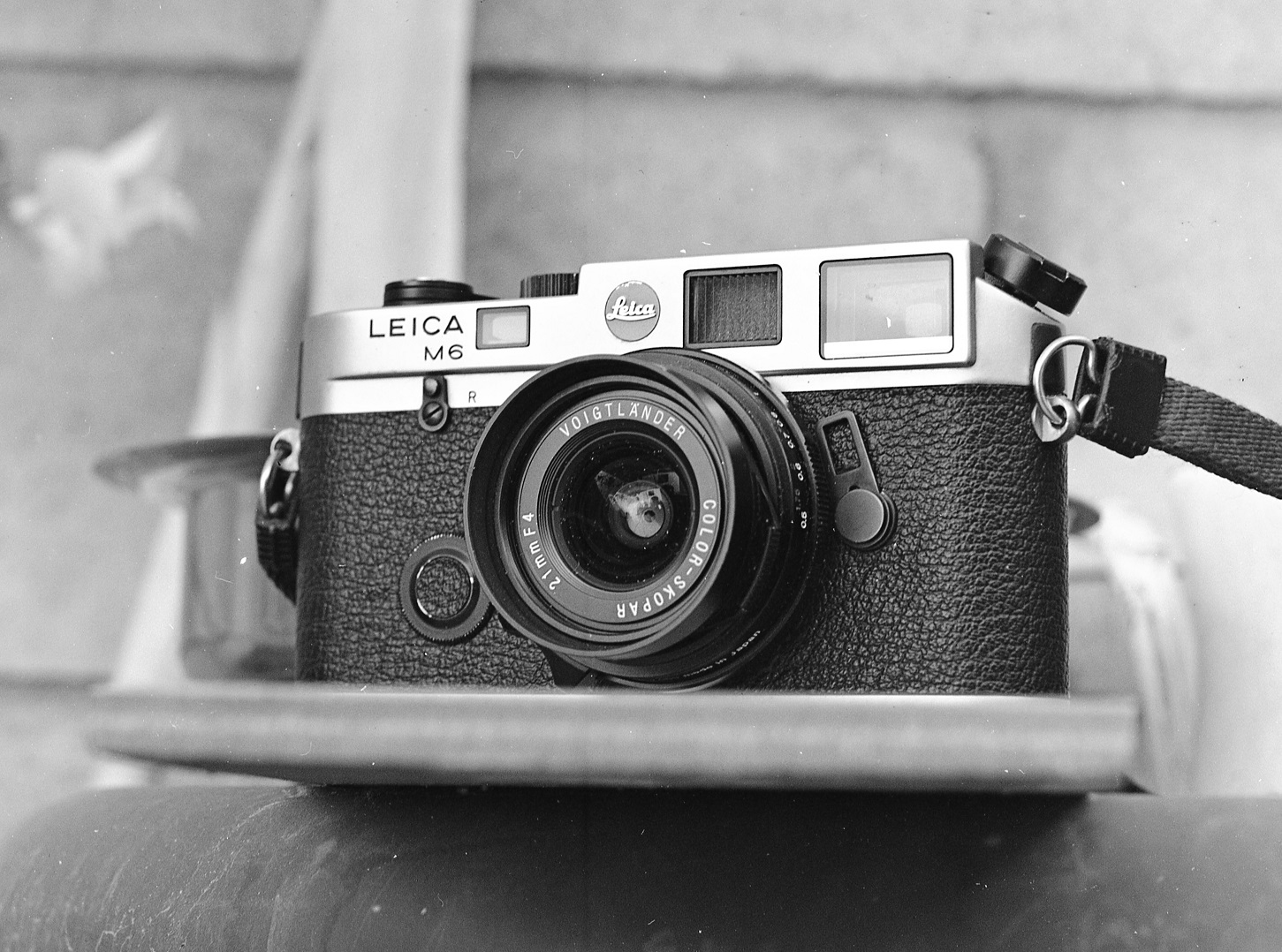

LIke Craig said, POTA is a good developer for high contras film. Also good when you shoot film on very contrasty environment. Bring out a lot of tonal range. I love what I can get with it using Aviphot film.
It lower film speed (about one step) and grain may not be the best for certain films so not your everyday cup of tea (of coffee). I use it when speed is not essential (like portrait/lanscape). Got hold of a big roll of Aviphot to cut for 4x5 and intend to use it with POTA @100.
Mamiya C330 80mm f/2.8 Aviphot 40 @40 using POTA developer (14min at 75F).
I ran the film tonight and mixed 300ml of developer. It developed a 4x5 just fine.
It's amazing how much this developer lowers the contrast on an ortho film compared to Xtol. I'll have to print it now, and compare to some FP4 I shot of the same scene.
