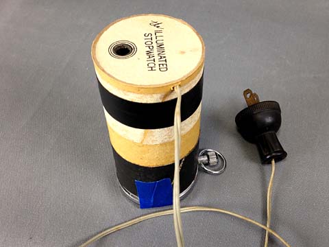

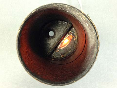

Years ago I made a cardboard gizmo using a cylindrical tube from a roll or spool off something that just fit the outer diameter of my old 1960s vintage mechanical stop watch. This was in a pre-LED era, so I used a small neon bulb and a current limiting resistor mounted under a flat mat board cover that closed one end of the tube. The other end was placed over the watch and taped in place. There is about a quarter inch hole in the cover that allows looking inside, but seriously limits any light coming out. It plugs in to a wall receptacle via some very fine, flexible two conductor cord (likely making the electrical code folks shudder!)
Were I making it today (or using it enough to justify tinkering with it) I would probably use a small battery holder on the outside and an LED of some sort.
You could do something similar using a box or tube of appropriate shape and size.
(And it appears the stopwatch may have stopped permanently, so maybe a modernization is in order! :confused: )
