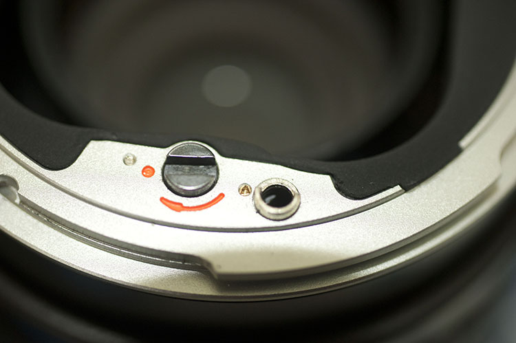

I am new to using a Hasselblad 500cw. The shutter works fine when the lens is not attached. But when I attach the lens I can't release the shutter. I have cocked the lens and the camera, I can attach and remove the Len with no problems. When I remove the lens I can release the shutter. I haven't been able to release the shutter on the lens manually. It is a new lens and I am not sure if I am doing something wrong or if there is a problem with the Len

It is a CFi 150mm lens. There is no pin inside the small metal collar that I can see. You can see right through.

I have checked that the shutter speed button is not on F.
I tried to reset the shutter on the lens manually with a pen but not thing happened.
My lens doesn't look quite like the one in the picture posted by Leigh. I have attached a picture of what it looks like.

OK. I've never seen a Hasselblad lens that had no pin. I think it's broken.
You might contact David Odess at http://www.david-odess.com/ and see what he thinks.
He's the best person that I know of to repair it (assuming you're in the US).
