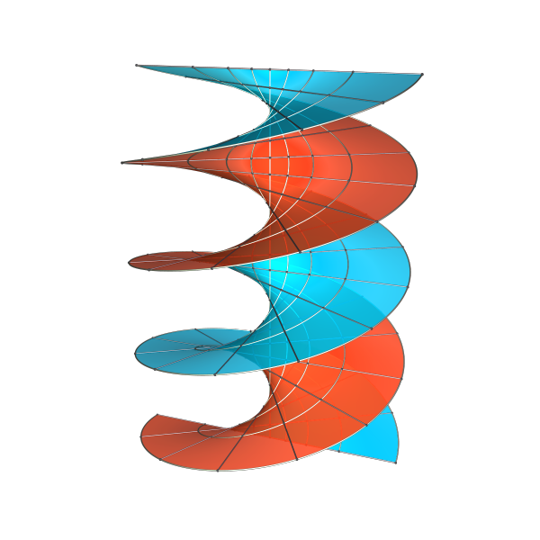

I found that the helicoid is locked in place by screws in a specific orientation, so the focus issue can't be due to a wrong turn. Please keep the ideas flowing!
Are you sure you understand about the helicoid? It just unscrews. But unlike a standard screw and bolt, there are multiple sets of parallel threads. It can "start" at different locations. Only one of them is correct. Usually there is no mark or any help what so ever. Getting it correct is trial and error if you did not put a mark on the two pieces when it was disassembled. (Sorry if you know all this).

The Helicoid referred to is when you have fully disassembled the focus mount, and are holding three very greasy parts with giant square threads in your hands. The focus ring is screwed onto the middle of the three rings, the lens elements hang in the front threaded part, and the mount at the back is connected to the third. It does not sound like you have gotten anywhere near to disassembling the lens this far.
As others have said, when you get these back together wrong, the zone of focus is off. In most lenses, the scale as marked will be off by exactly 1/6 of a full turn of the focus ring, or possibly a multiple of that--check yours to see if this is the case. This is deep surgery, probably worse on a Blad, though I've never had one apart, and it's common for people to get it wrong, not understand the problem and give up and sell the lens as it is, messed up. It's not hard to fix, but may not be an at-home job for you.

Just so we are all on the same page, my take on it is that in your pictures "EXTENDED" and "FULLY CLOSED" it is showing the movement of the standard thread that allows twisting of the lens, not the helicoid. You have to put the helicoid inner and outer pieces together with that standard thread somewhere between "EXTENDED" and "FULLY CLOSED." The helicoid threads will fit together in a number of different places and only one is correct.
One way to tell which is the helicoid is to follow a groove all the way around. You will see that it will look like you are skipping some of the threads as you progress because there are multiple parallel separate grooves.
