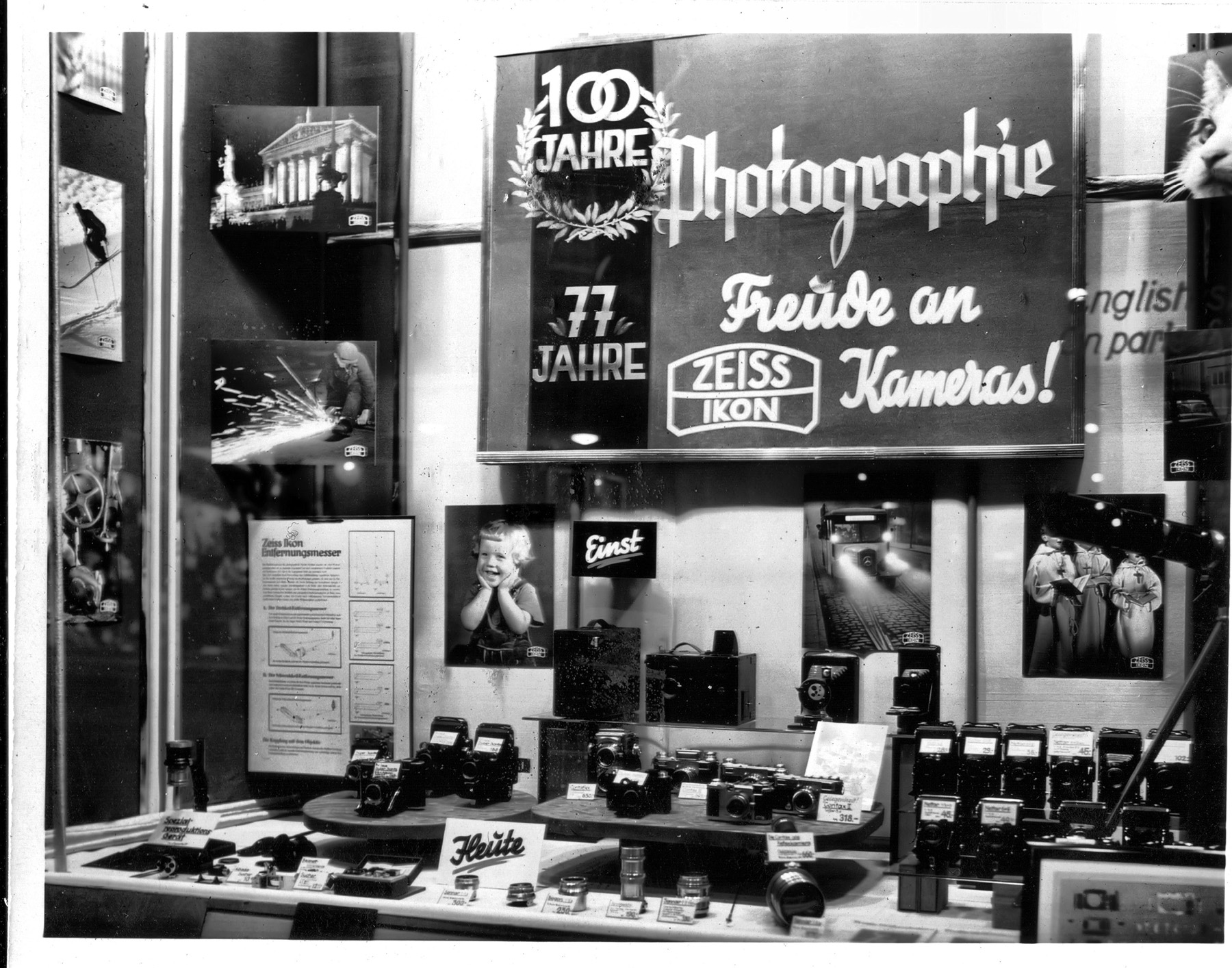

And one photo you might find interesting - Super Ikontas in the lower right:
