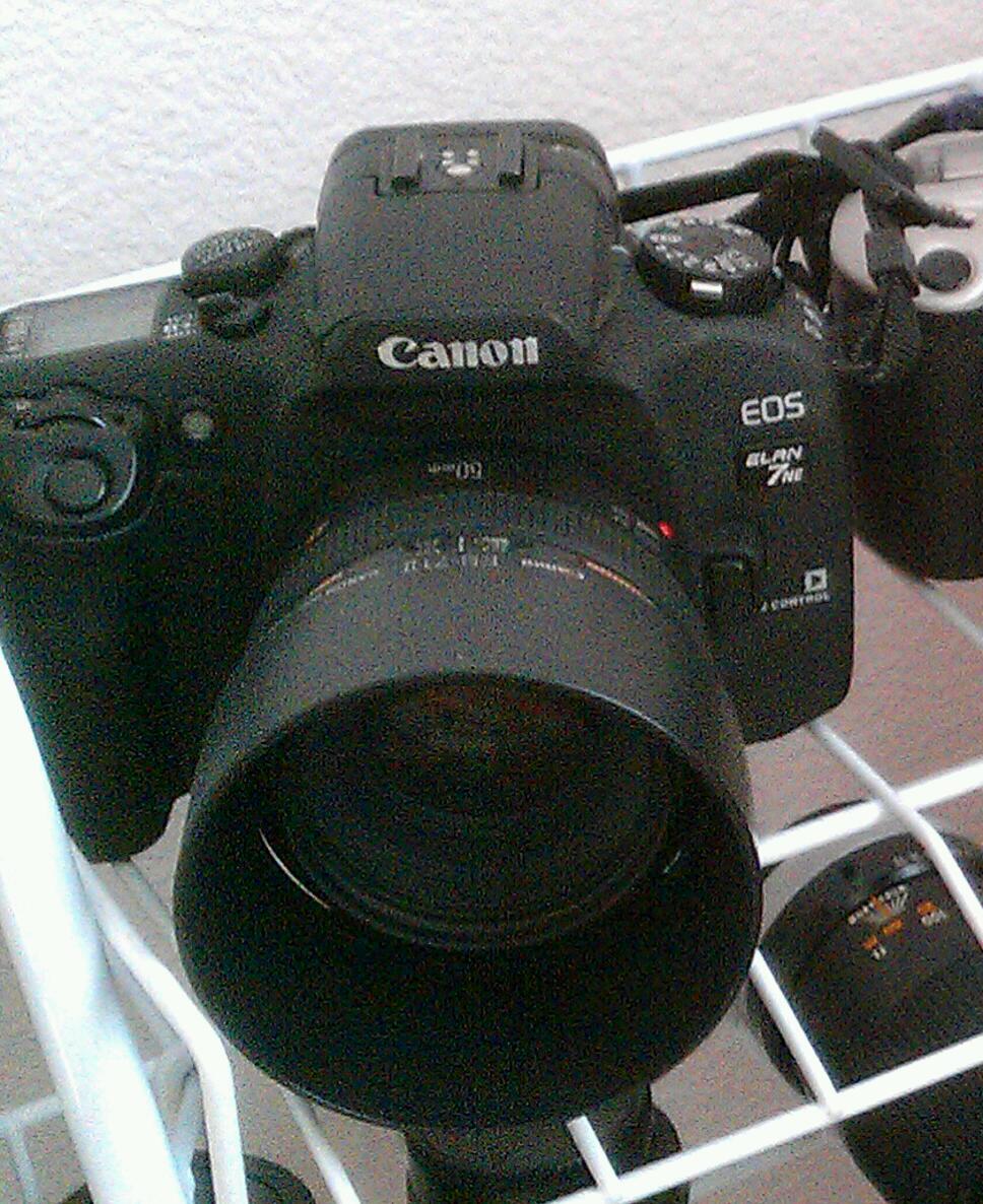

The 7NE is one of Canon's best EOS film cameras.
Without glasses, the eye-control focus on my 7NE works very well even in very dim light (single 60W bulb under lampshade in a big room). I was impressed.
With glasses, the eye-control works for me only in bright daylight.
