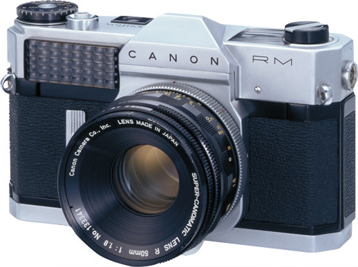

I recently got a few Canonflex RM cameras with a Super-Canomatic 50mm 1.8 lens attached. I read somewhere that FL lenses would work well with these Canonflex cameras, but I also read conflicting information debunking this claim. Thus, there didn't seem to be any clear-cut information if FL lenses would be compatible or not.
Are FL lenses compatible with Canonflex cameras (which have R mount)?

CameraQuest says:
"The Canonflex MOUNT is almost the same as the later Canon FL/FD series cameras, but NOT the same. Lenses have a different set of connections at the back. In practical terms, you may damage your camera or lens by interchanging earlier Canonflex bodies and lenses with later FL/FD bodies and lenses. Some will be OK, some not OK, so be careful."
https://www.cameraquest.com/canonflx.htm

That's exactly what I'm talking about. There doesn't seem to be a clear-cut answer. I actually read this excerpt a few days ago :wink:. To be specific, I would like to see if I could use a Canon FL II 50mm f/1.8 lens, but can't find any info if this would damage the camera or not. Would do you think?

My guess is that the 50/1.8 FL will work on the Canonflex but I don't say that from experience.
My reasoning:
It's the most common FL lens and surely, if there was a problem mounting it on a Canonflex, we would have heard lots of stories warning us about it. :smile:

The Canonflex automatic-diaphragm mechanism does not work with FL-and FD-lenses.
Thus the term "compatible" must be defined.
FL- and FD-lenses can only be used in stepped-down mode.

Yeah, that’s what I’m figuring regarding the automatic-diaphragm mechanism, that it wouldn’t work, but that I could still breech-lock the lens on the RM and simply stop-down the lens and fire the shutter without damaging anything. So as long as that’s all good, I’m in business.
