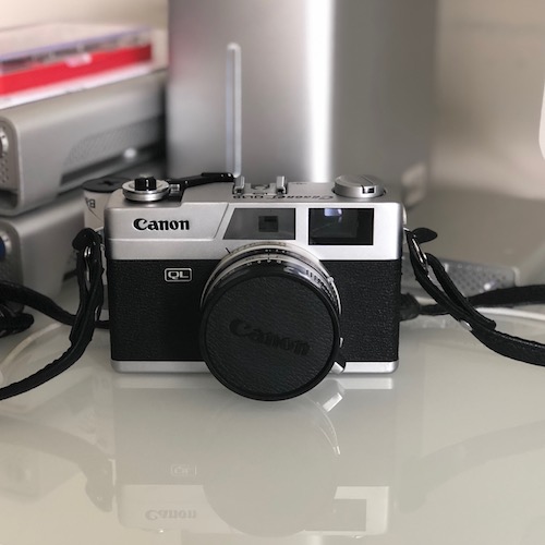

The focusing ring on my QL19 is totally stuck and I'm planning to repair it myself. The other camera functions work just fine and the lens is in mint condition.
Can I access the focusing ring to look what's wrong removing the front element or do I need to remove the whole lens from the assembly to the chassis of the camera?
Any advice would be greatly appreciated!
Thanks!
