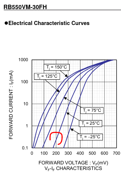

If you are reasonably handy with electrical stuff, you might consider to adapt your camera permanently to silver oxide batteries. All it takes is a Schottky diode with a suitable current rating and forward voltage. You'll want a rectifying diode with a current rating of 500mA...1A. Do not pay attention to the nominal current and forward voltage ratings, because you are going to use that diode at a much smaller current. You need to look at the datasheet (example below)
Circled in red is a typical operating point in the camera's meter circuit: a fraction of a mA, and a voltage drop of 200mV. Just what you need to convert the 1.55V of silver-oxide to the 1.35V expected from mercury. Typically the diode would be installed under the bottom plate, near the battery compartment. I can't give step-by-step instructions, as this depends on the camera and your proficiency in things electrical. And probably naysayers will point out that the voltage drop varies with current... I contend that the associated error is less than systematic metering errors as arise from, e.g. a patch of sky or sunlit rock in an otherwise shady scene.
It does -- but what's the full scale current for that milliammeter in the metering circuit? I'm guessing if you select your diode to correct for that level, the error in lower light will be completely acceptable (as was the case with no diode).
Another way to solve this problem is with an actual regulator device (zener diode?) and lithium coil cell. I bought a converter recently for my Pentax 1/21 Spotmeter that uses a 1632 cell and a regulator, ought to run for years with the tiny current draw of that meter (especially since it draws effectively nothing while in the closed case or with lens capped). What's the original cell in that QL17? I've got one, but I'm not at home. If it's a PX640, there's a one-time solution for $30 that I can link when I'm home.
