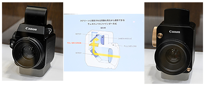

I Google translated this from CNET Japan...
Canon unveils unprecedented "analog concept camera" - waist-level digital camera, commercialization yet to be decided
The exterior design will come in two varieties: a retro design reminiscent of old analog cameras, and a simple box-like design. Various design directions are being considered.
Canon is conducting a survey at the venue regarding the design, price range, etc. This model is merely a reference exhibit, and no decision has been made as to whether it will be commercialized, but the survey asks people what price range they would be willing to purchase it at if it were actually sold, with the lowest price range being "under 30,000 yen" and the highest being "over 100,000 yen."

Nice to see some creativity in this space. Hasselblad has done well with its retro themed MF cameras so there's definitely interest in this. Looks like it's a fixed lens concept though, if I'm not mistaken?
Flip the articulating screen 90 degrees to the half up position on your existing camera and you have a waist-level digital camera.
A square sensor is an interesting idea. One could choose landscape or portrait without rotating the camera.

It appears to be a square format. How else would you use the viewfinder if you turned the camera if it had a rectangular sensor to switch between landscape and portrait mode?? There's no revolving back like a Mamiya RB67 or RZ-67.
