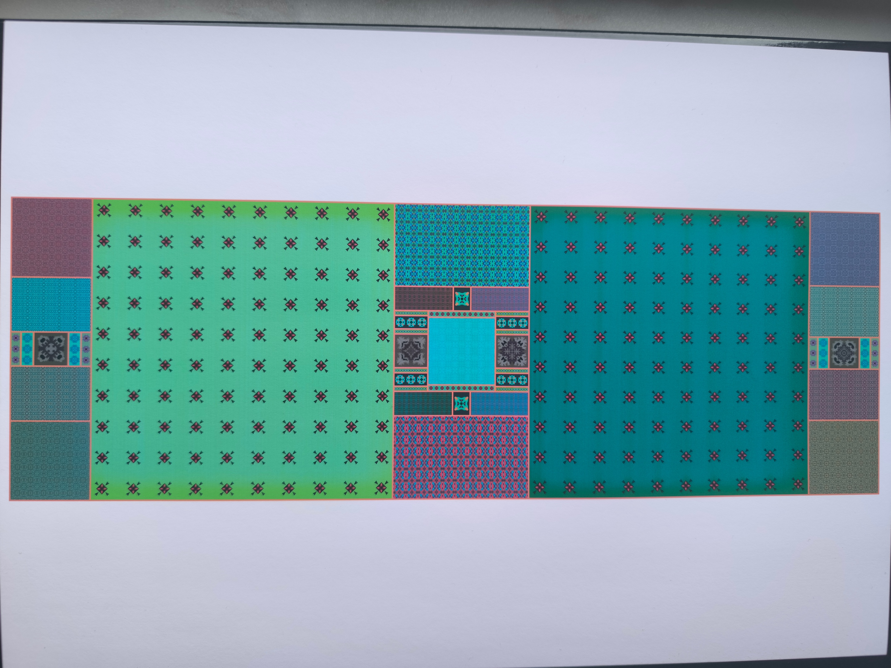

Hello everyone. This is my first post in here and I hope someone can help educate me on my issue with my canon pixma pro 100 print.
I'm printing a relative straight foreword image created in windows paint. The colors are predominantly out of gamma.
That means the colors are thrown off, and it mainly affects the two big squares in the image.
The big problem is the border of greenish yellow around the inner edge of the big squares. It is supposed to be one flat color with the symmetric shapes inside of it.
I have now made quite a few prints on different papers and different settings but they all come out with this 'blemish'.
Please give your thought and help me understand my issue.
Tech info:
Canon pixma pro 100 bought second hand but in good printing condition with oem ink in it.
OEM ink is now replaced with (about 2-3 years old) Octoink that I got from a photographer who used to use it for his pro 100
Printing from qimage 2022.117
paper: canon mp 101
icc profile: mp 2/3
rendering intent: Saturation - charts/graphs
Black point compensation: ON
Automatically control driver color mgmgt when possible: ON
Dithering: None
Thank you!

Is it possible that the areas are showing severe banding from the out of gamut colors being downsampled incorrectly because your colors are outside of what the printer is capable of?
I can’t really tell from your photo what’s happening. It would be helpful to have a 100% crop of the affected area. Also it would help to be able to compare with a 100% crop of the original file.
I just want to make sure I’m clear on something though: the colors in the file are mostly falling outside of the gamut? This is a major issue that could cause all kinds of problems including what you see in the print.

I really don't know what is happening. I'm still pretty new to the technical aspects of printing.
Here is the soft proof from Qimage, showing the out of gamma areas.
Original crop Print Crop
Original Crop
I hope this can help.
I also see a vertical (orientation in your original example) color defect/deviation in the right-hand big square that only appears between the lozenge shapes. I've increased contrast on a little snippet to illustrate it:
I wonder if it might be a problem with smeering or ink bleed due to a viscosity problem with the 3rd party ink you're using. If I were to hazard a guess, the yellow ink has a different viscosity than the OEM ink, resulting in a bleeding problem where the nozzles basically keep bleeding ink for a little while after they should have stopped jetting.
My suggestion would be to go back to OEM inks and see if the problem goes away.
