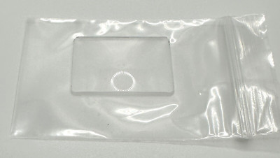

I also found this listing on a popular auction site (hopefully links allowed). It doesn't specify in the title that it's a split image screen, but it sure looks like one to me in the photos. I don't, however, see the rectangle of semi-silvered area in the center that I believe the FTb meter relies on for its excellent partial metering.
The seller tells me these came from the parts bin of a Canon warranty repair shop that went out of business in the early 2000s. He wasn't sure whether it was split image or microprism, and said he'd be fine with a return if it's the wrong type. I may roll the dice on this and see if it a) fits my FTb and provides accurate focus, b) is a split image, and c) still gives me accurate metering.
