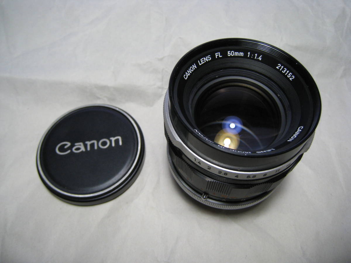

I recently purchased a very clean Canon FL 50mm f1.4 that I intend to use on a Canon FX.
According to this website (https://www.pacificrimcamera.com/pp/canfl50f14.htm), my lens is the second version.
From what I can gather after a bit of research, there doesn't seem to be much difference between the second and third version, but it is suggested that each version has a different optical construction. Would anyone have any more information about this?
Also, while I imagine there may not be a huge difference or any difference at all, I'm curious if the the third version of this lens is considered a better lens in its rendering, etc.
Thanks for your help!
-Paul
