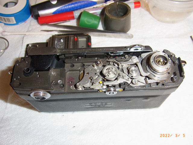

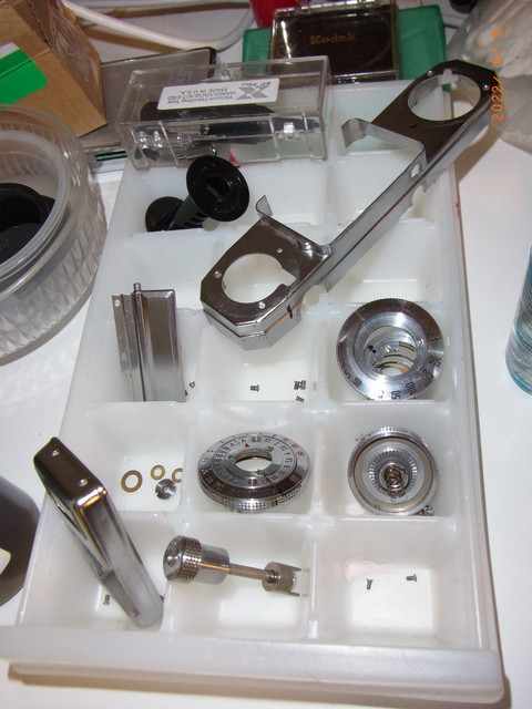

These cameras are 50+ years old and having a clean-lube-adjust done is typically required. These are complex pieces of machinery with 2000 parts in them. It can take a couple of hours to tear down, clean, lube, adjust and repair. You can look around for someone cheaper, get some online articles and try the repair yourself, or get another camera. Sometimes the fix is simple, like dropping the bottom plate and hitting the right spot with some light camera oil. Other timer- a major teardown.
Cleaning the viewfinder on a Nikon S4, 15 minutes. 4 screws and the name plate is off, a few screws- the cover glass is off and surfaces are accessible.
Cleaning the viewfinder of a Contax Rangefinder- several hours.
What idiot designed this camera?
