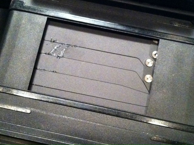

sounds like the shutter buffer is disintergrating.
Have a look at the shutter blades - if you see any "black gunk" on them then the only way to fix it is to strip the camera and clean all traces of the gunk from the shutter.
I've fixed many of these in my time - it's a common Canon fault with EOS and some T series shutters

Cleaning the shutter is only the first step, as the disintegrating bumper is still in there. You'd have to open it up and remove all of it, then install a replacement piece. No, I've never done it. One could, of course, continue to clean the shutter blades as the problem crops up.

I purchased Elan IIe as lens cap. Camera was unused for years. Worked OK for first day and then low battery at few frames and later every shutter release.
I took slight detour about this problem with information on the web about batteries. Now I have two :smile:.
But it appears to be the buffer black gunk. I cleaned it with digital sensor cleaning swab and lens cleaning tissue on it with 99% alcohol. Camera started to works again.
Don't know for how long. Yes, this buffer needs to be out to solve it permanently and as reported online it is no need to replace it, just to remove.

I had a similar problem with my Elan IIe. I cleaned the shutter blades with denatured alcohol and lots of cotton swabs.
I've heard of people cleaning the buffer goo from the bottom track of the shutter using a cut down piece of business card. I'm not sure of the procedure to do this, but when it can be gotten rid of, it is a permanent fix.

I did it with inkjet photo paper stripes. Without it goo was just keep on spreading on blades. The real test was to use it at 1/4000. Only after I cleaned it with more effort and time it started to work.
