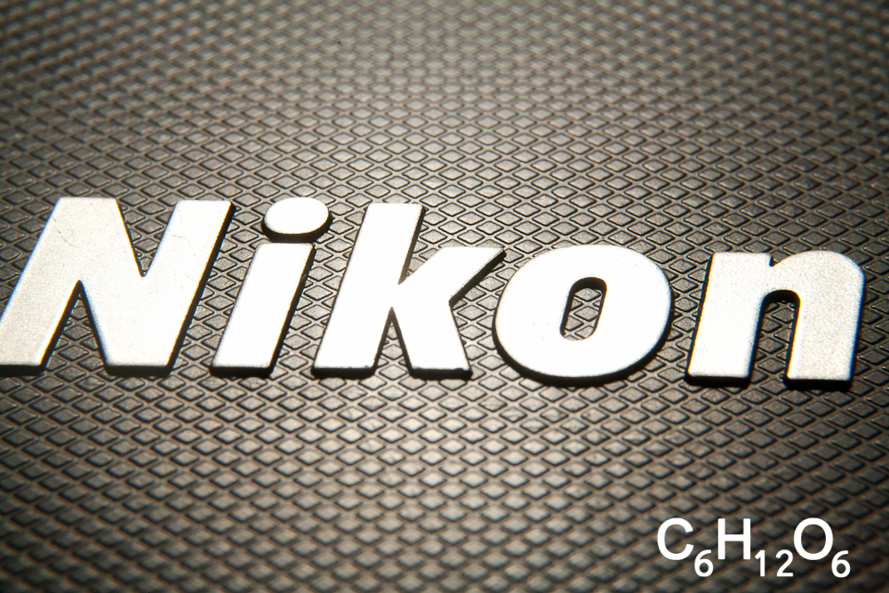

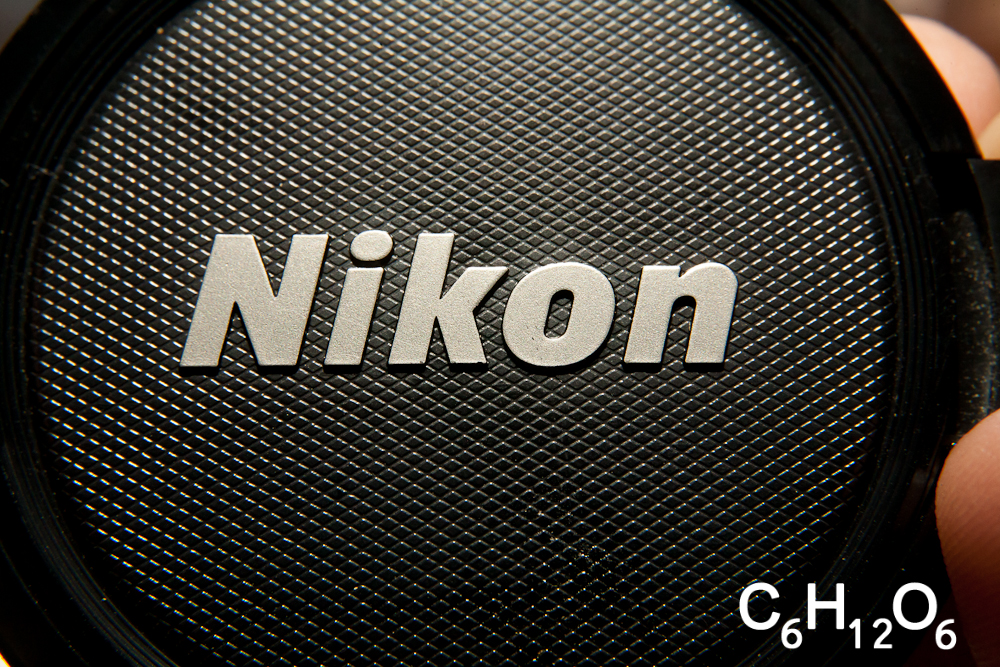

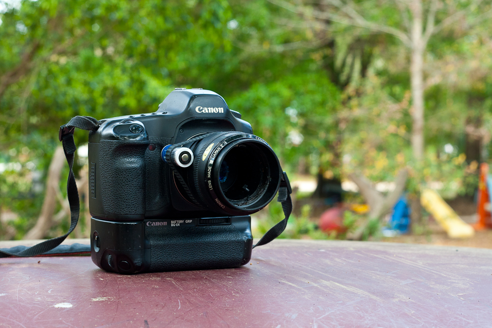

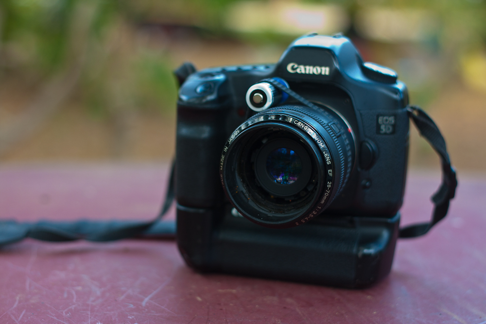

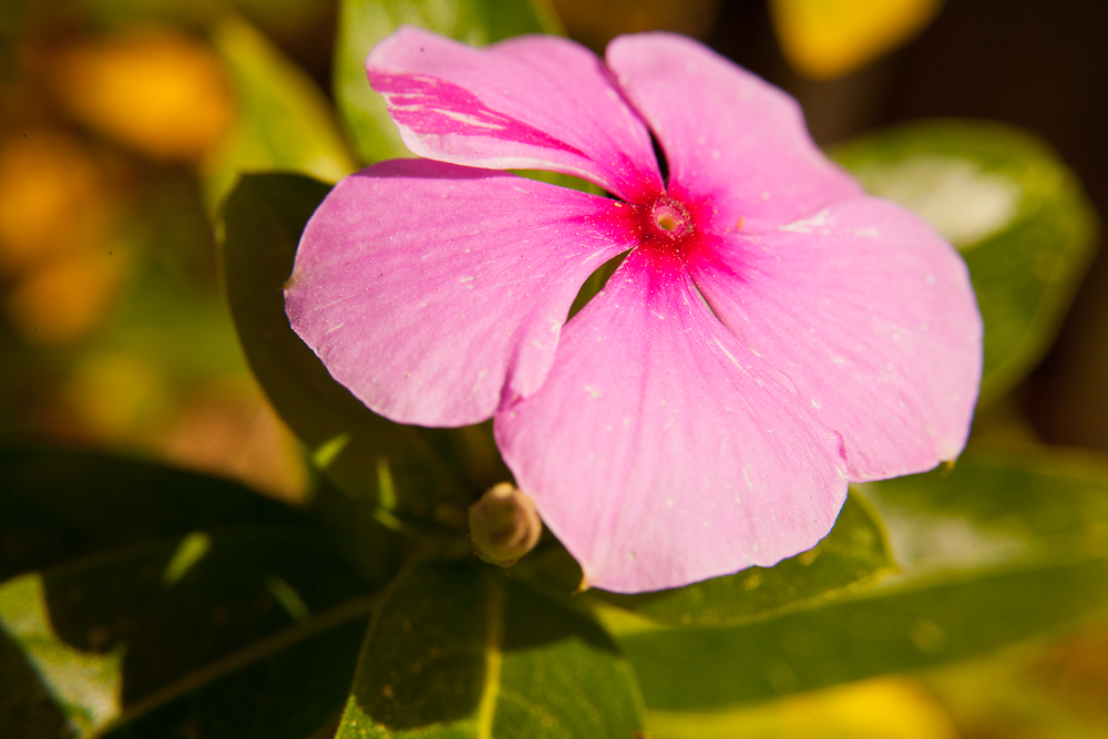

Samples below @ 28 and 50mm. From what I've shot so far I am very impressed with the level of detail and the background blur. Stopping down adds a significant amount of DoF, especially f11 and above. Also shots of what the whole thing looks like bolted up to my EOS 5d
28mm
50mm

So to clarify, you remove the front element from the 28-70 and you get ultra close focus? What is the battery banded to the lens for?
yep. Battery is because the grip on my copy is loose and coming off
