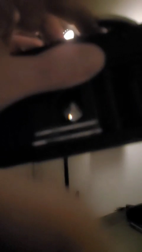

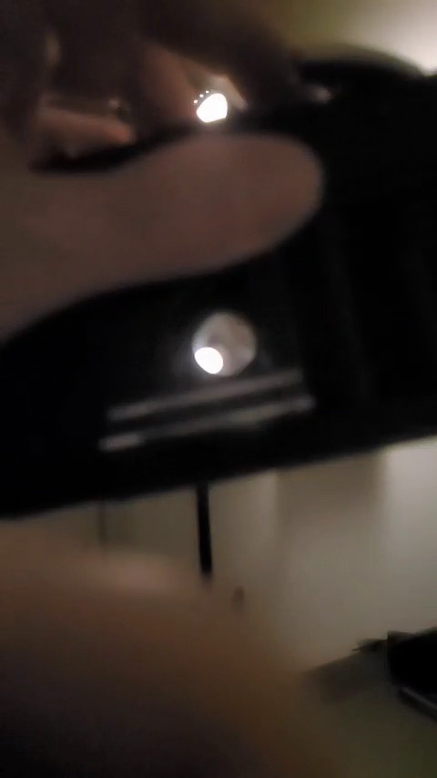

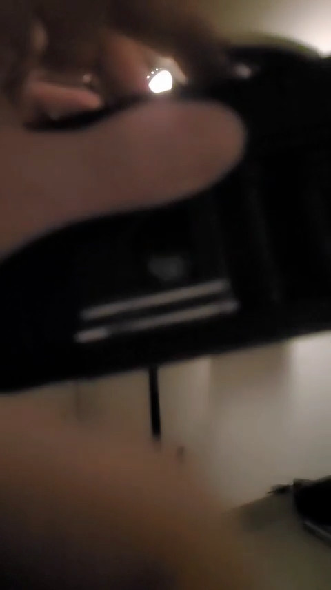

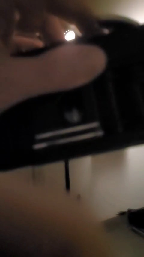

I'm not familiar with the Demi, but it looks like it has a traditional leaf shutter. If you want to get to the bottom of this you would need to strip the shutter, clean the components and reassemble with specific lubricants. There is no eccentric to tune the speeds. You would also probably need a proper tester for the 1/500=2ms settings (960fps gives you +/- 1ms).
If your measurements are accurate, they are typical for a 50+ year old camera that probably wasn't serviced. And not all that bad really. But it seems the camera has other issues. Apart from the shutter these cameras are usually simple to take apart. Helicoids can also be tricky.
Well, as per the above, I'm still probably not gonna jump at trying to fix the shutter unless I'm entirely prepared šŸ˜…
But, as for the cleaning routine, yeah I see watchmakers do that all the time in videos. Disassemble the geartrains, throw it in the cute little baskets into the cleaning machine or an ultrasonic cleaner... but then put them all back using multiple of like 10 different lubricants. That last part was always the confusing part.
Is there no eccentric screw? Nothing to adjust it? I know a sluggish shutter usually ends up requiring that cleaning procedure you outline, but how ever would large speed deviations be fixed in leaf shutter cameras without a way to adjust it?
And yeah, the 1/500 "measured" time is approximate, I based it off what I saw of the shutter motion in those few frames. I saw 2 entirely open (4 and 5), then a partial opening on the preceding (3, beginning at the end of 2) and following (6) frames, so I counted those as 0.5, putting the total around 3 frames. 3/960 is actually 1/320, but that's the gist of how I "measured" it. Here are the video frames, from 1 to 7:
mpv-shot0001.jpgmpv-shot0002.jpgmpv-shot0003.jpgmpv-shot0004.jpgmpv-shot0005.jpgmpv-shot0006.jpgmpv-shot0007.jpg
Edit - heh, you can "play" it pretty easily by maximizing a frame and advancing through them with the arrows!
I guess the escapement sub-assembly is a sort of eccentric; you can slightly adjust its position to tune the timings. In other shutters you can bend a tiny pin. Not sure if these techniques apply to the Demi. Usually cleaning and lubricating will bring it within specs, which is a 1/3 stop (at and below 1/125s) and a 1/2 stop (above 1/125s).
(BTW, leaf shutters have an effective exposure time that depends on the f/number for the faster speeds)

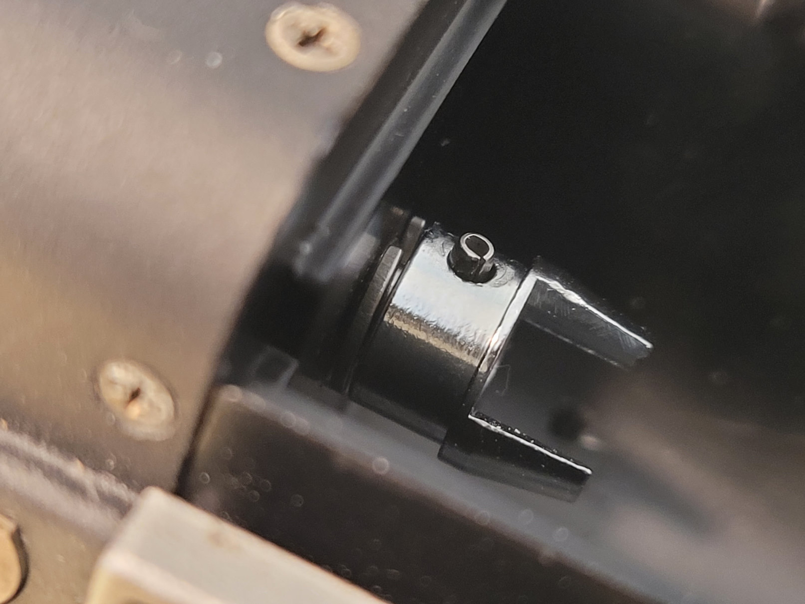

It seemed tight already, but either way I went ahead and took it off, keeping all the parts together. And then when referencing this page on EE17 disassembly I noticed something... seemingly, there should be 2 washers on the fork. Mine only has the left one, the one with the larger notch:
Without it, the "fork" piece that is fastened with that pin going through it, is pretty loose and jangles around.
I suppose I can find a replacement that works, right? Guess this is kinda a small-time "repair" lol
On the other hand, I'm curious if the other parts around the lens are less high-risk to investigate? Like the aperture and shutter dials. They're a bit stiff on mine, and the "filter factor" lever takes a LOT of force to move back to 1x.
