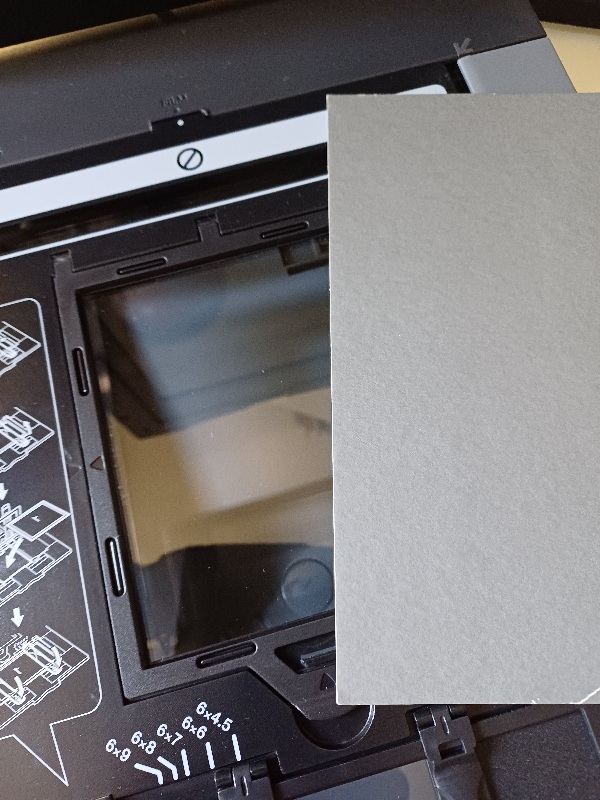

OK, I was able to fake a calibration with a trimmed down sheet of white paper, and get a clean black-and-white transparency scan. I went to try it out in color, and Vuescan promptly told me that I needed to install drivers, that were already installed, and already working...since I JUST SCANNED AN IMAGE!

Yes, there are. It's the white area, demarked by a "no" symbol next to it. When scanning in film mode, the scan head will advance to this position, stop, and wait for you to start the transparency scan. I have not gotten this far in decoding the driver yet but I would bet this is where it's doing it's calibration at before doing a transparency scan, because if you scan a transparency that has part of the image in the area where it stops in, it will drag stripes that coincide with the part of the image that was in that area through your scan.
It will keep dragging stripes through your scans, until you put a white target back in that area-then it the stripes stop and it scans nicely again. It's about 17-19 mm from the top edge of the scanner glass.

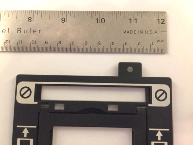

The holders for it have a clear window opening the width of the light source at the far end. The opening is
The calibration function relies on there being nothing in that area, not something white in that area - it is a precisely shaped and sized opening that allows the light from the light source to go straight through the platen and to reach the scanner sensor.
My understanding is that the size and placement of the opening is important to the accuracy of the calibration process.
This is the calibration end of the medium format holder - for the 9000. I have a sheet of white paper behind it for the photo, but when on the scanner a look through that empty calibration window reveals the glass platen and the inner workings of the scanner below.

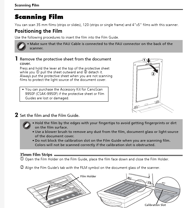

I think the calibration process is interpreting your setup as if you were scanning reflection media. In other words, light from below, not light from the lid.
You have removed the protective sheet, haave you not?
From the manual:

As you can see from the attached image, the calibration area - at least if that is what it is - on the holder is light grey, not white, nor greycard grey.
