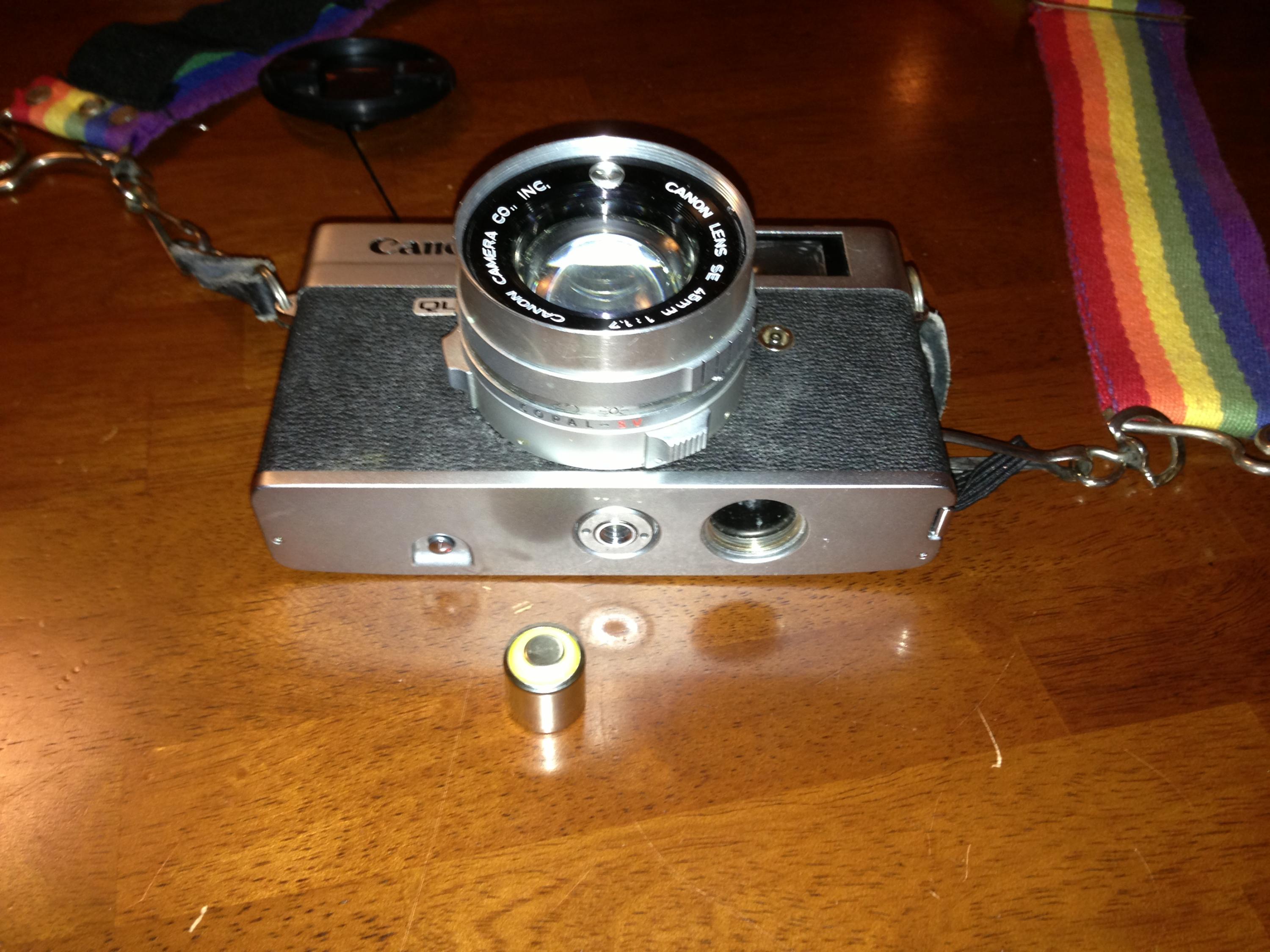

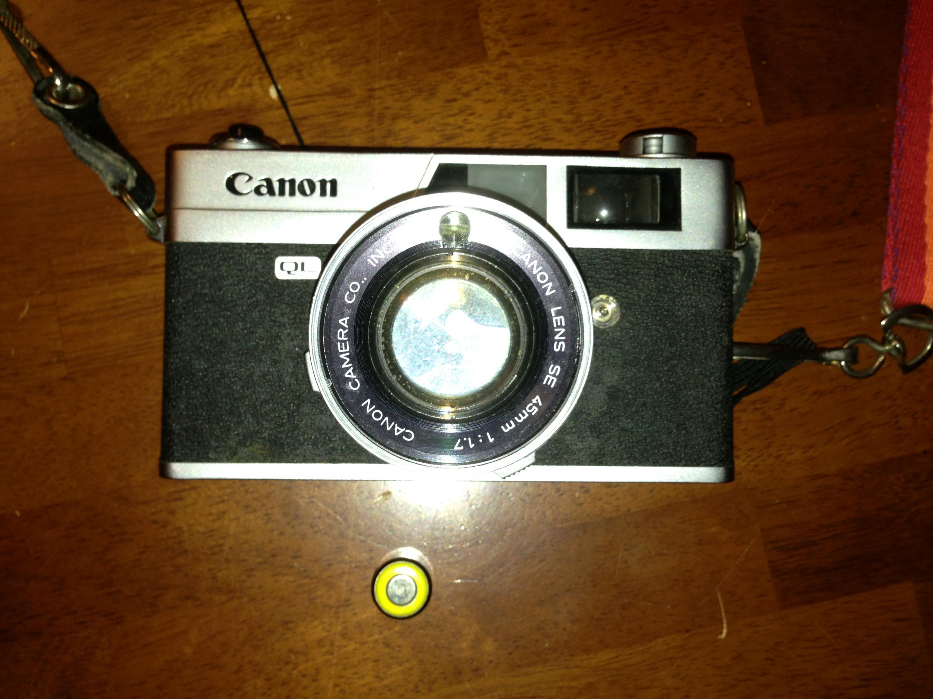

Hi Everyone,
I have been getting back in to film over the past year and I have been lurking here recently.
I have been interested in the Canon Canonet QL17 and have been watching them on ebay. Well today I acquired one from my Father-in-Law, that he said he had purchased in Japan in 1966. It appears to be the original model with a 45mm 1.7 lens. The camera seems to function properly (I will run a roll of film through it tomorrow to see what I get). I have been online all day researching it and most of the info I have come up with deals with the giii which seems to be very similar but with a few changes - mostly the lens (40mm vs 45mm) and the battery.
I am looking for info on the battery as it seems very different from the type used in the giii. The battery door says 1.3v which I believe is the same as the giii and the battery from the camera doesn't have any info on it other then a patent #. I have posted some pictures here (sorry taken with my iphone) including the battery that I pulled out of the camera. Any help regarding the battery or any other information would be greatly appreciated.
Thanks in advance.
Joe

according to the photo, I think the battery you have is LR-50 or PX-1. But the manual said it needs 625 or PX-13. Of course any of these battery would have wrong voltage and might cause wrong exposure.

I think the OP may have a validly odd battery question he's asking.
If the battery in his picture came from that Canonet QL17, what is it?
It's not a PX625 format. It's much too tall for that. (I have a QL17 GIII and a freezer full of 625 mercury cells.) But references I've looked at, including Canon's historical archives, says 1.3-volt (MP) mercury. And he says the compartment door reads 1.3-volts.
The only form factor I could find that matched that voltage, used to be available in mercury, and looked similar was a PX640. But even that seems just a bit shorter. And nowhere could I find a reference to 640s in Canonets.
There is the PX27 format, but I believe the voltage is incorrect (5.6-volts in the original mercury version), even though it closely resembles the photo.
So what is that battery?
(Regarding camera model, I also note that his lens collar levers are significantly different from other QL17s.)

That battery looks exactly like a PX-640 -- a 1.35v packaging of two mercury cells. I don't think it was ever intended for a Canonet but iof it fit it may have actually worked.

I have the GIII and the 625 fit. But according to the picture from the op the battery is PX-1a form factor. and the op has the original QL17 not GIII

I think you are correct. Visually, the PX1A form factor looks identical. And I have now found a few references, such as this one by Kim Coxon on the RFF (3rd post down), referring to the earliest Canonet QL samples using this battery before the switch to PX625 mercury cells was made.

There were 3 versions of the Canon QL17. Yours is the earliest version. The canon museum page lists it as a 1.3v MP mercury cell, but ive also seen a similar battery listed as a PX-640, which is about double the size of the usual PX625's, but still 1.3v. So a Wein zinc-air cell will work, but you will need a adapter or something to fill in the gap. A wad of aluminum foil will work, or a spring. A 1.5 volt silver oxide or alkaline will work as well, but you will need to adjust the ISO by about half a stop.
Either way, do not stack two 1.3 or 1.5v batteries together, you will not get the correct voltage.
