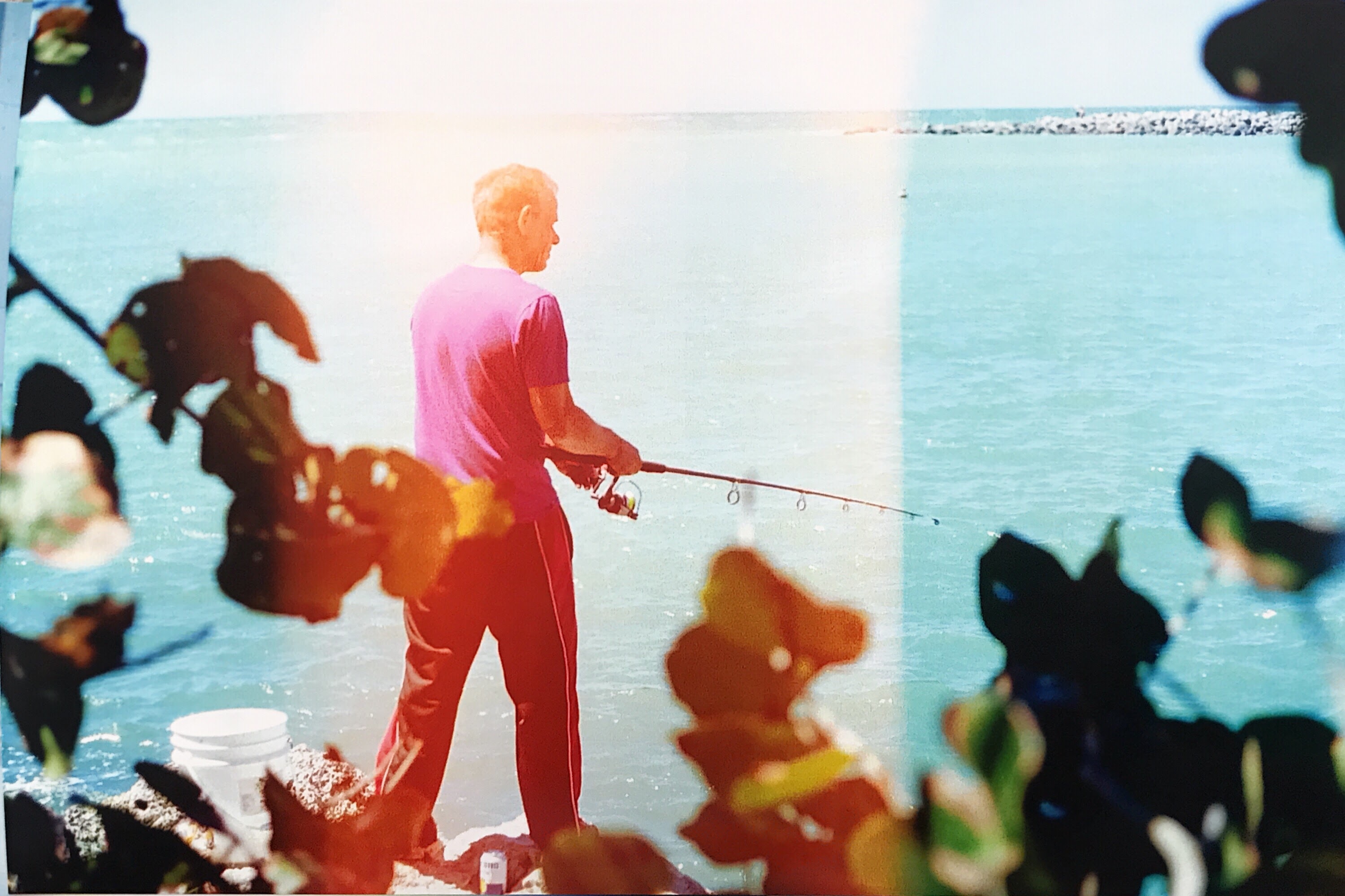

Good day everybody!
I am new here in the forum and am also planning to stay! I've recently dabbled more into analog film photography after finding an old Canon AE-1 and Contax RTS II with a 1.4 lens in my basement.

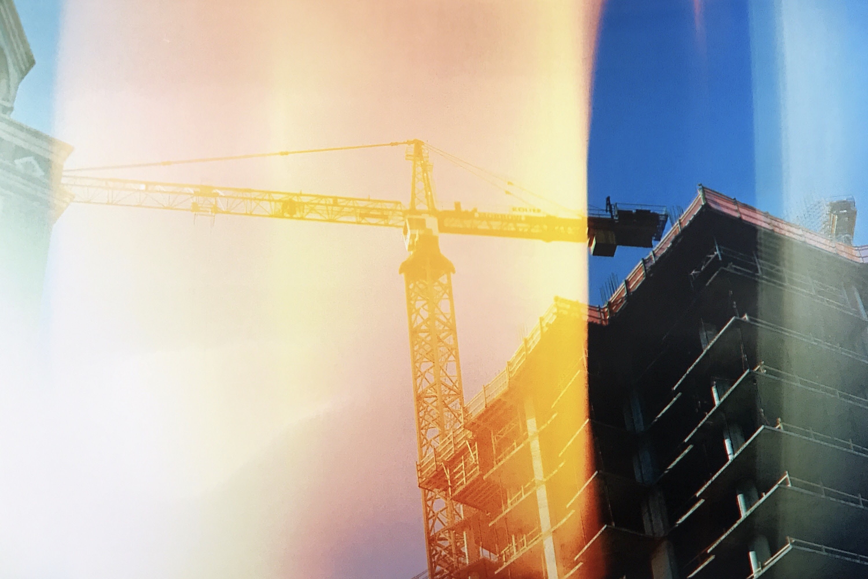

I digress. After having shot 2 rolls of film with my AE-1, I noticed that there seems to be a light leak or something like that. Sorry for not being very specific but I've attached a picture for reference. Weird enough, usually the last image turns out to be fine. I've also removed a small lump of dampening material that I found stuck behind the mirror.
So far I can rule out X-ray or heat exposure for these artifacts if you can call them that. I also taped off the back and the seams of the camera on the second roll but that didn't help.

Hi Anthony, welcome to APUG. I'm sure more people will jump in. IMO this looks more of a shutter problem than a light leak. If that is the case then your AE-1 needs a CLA (clean lube adjust). You should test the RTS II too - you will probably have better luck with the Contax. Cheers

Your shutter seems to stick that is the 2 curtains didn't travel at the same speed and across the frame. Actually if I were you I would try to shoot a lot of blank shots like a few hundreds and then try with film again. Open the back shooting blank and look at the shutter you may or may not see the problem.

A shutter failure would not produce such a bent edge-line. Nor would it produce a reddish hue.
That artefact of alternating short pieces of white and red exposures can be explained by a leaky hinge-seal.

That seems to be quite reasonable since I checked the condition of mine and it seems quite deteriorated. It would also explain why the last picture is fine since I rewind the film right after I'm done.

As mentioned by AGX check the seals all around the back of the camera. You may need to change all of them including the one for the mirror. This is something you can do yourself, there are lots of tutorials and Youtube videos.

A-1 cameras have been around a long time and light seals go bad. So a re seal and the mentioned CLA is in order.
