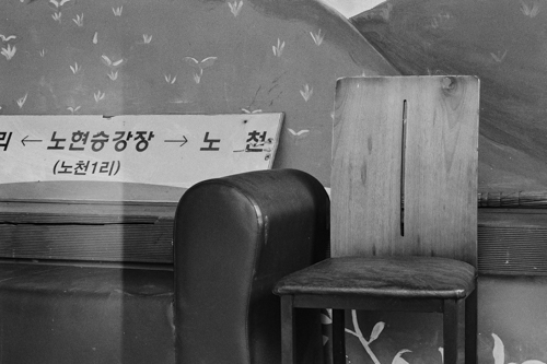

Hi, everybody.
I'm new here so I hope this is going in the correct thread. Anyway, I'm having what appears to be issues with shutter capping (I think that's the term) with my AE-1. I shot a series of shots yesterday and they all came out with a faint line in the same position on all of them. It was at slower speeds rather than higher speeds as most people talk about with shutter capping. It doesn't extend beyond the exposed frame so I'm certain that it isn't a light leak. You can see the line on the left side of the photo. Do you think that shutter capping is the actual problem and that it just needs to be tightened?
Either way, I'll take it to the shop to have it repaired, but I live in Korea so it's always best that I go in with a decent idea of the problem so I can prepare an explanation in advance due to language barriers.
Thanks!

Hi, everybody.
Thanks!
This looks like shutter bounce. Yes it can be repaired.
