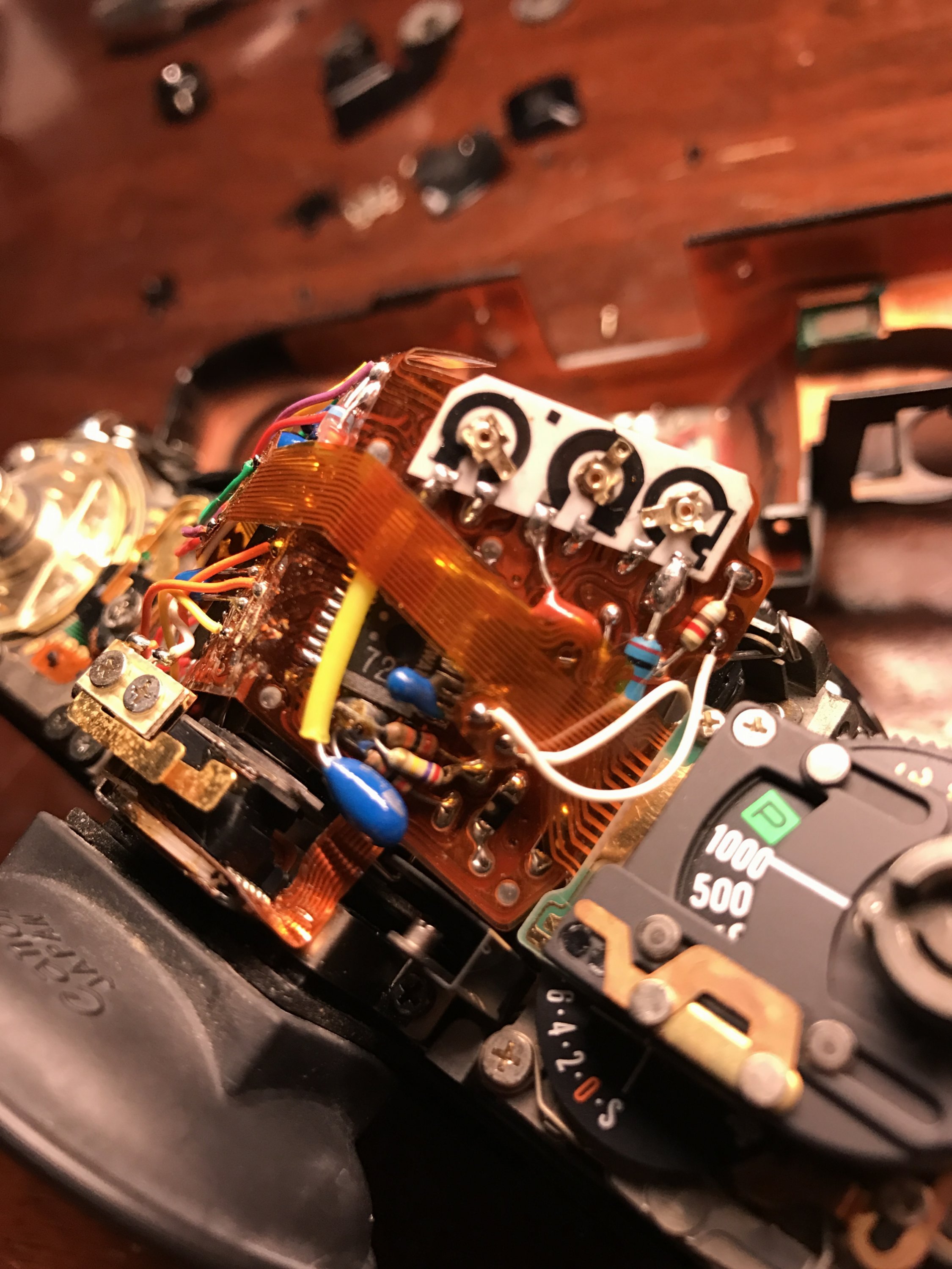

So I spent about an hour reading over the repair manual and I'll be honest, still not super confident with what I'm looking for even though I understand the concept of how it works. Here's what I've got. Does this appear to be the problem?

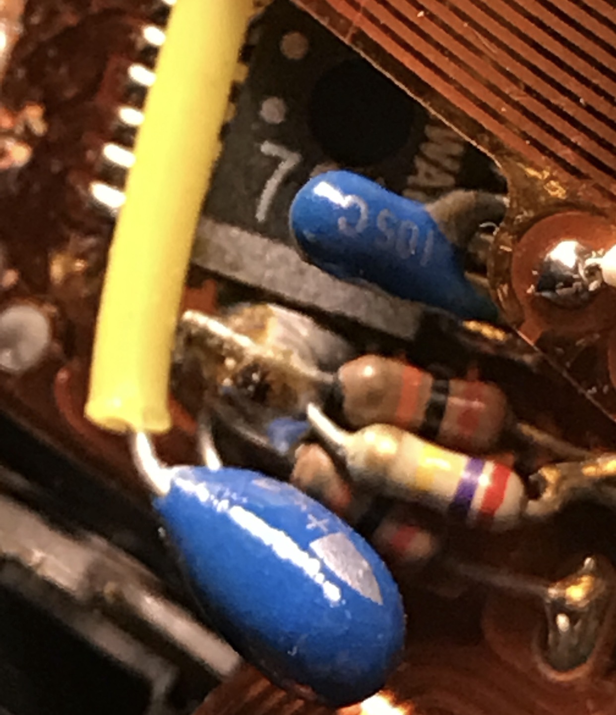

Sorry Hamberger, i'm not sure if i follow you. What do you see that appears a problem?
I'd suggest you to first take a deep look to the repair diagram circuit before doing anything. Sadly i don't have the spare time right now to do a look to the diagram. Give me more time.

IT'S ALIVE!!
It appears that this camera was previously [attempted to be?] repaired as that connection had burned solder.
I removed the old solder and had to do some adjustments to get the pins where I need them but after resoldering she started working!
You definitely pointed me in the right direction Flavio, thank you!
