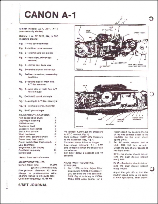

The problem you're describing could be a short circuit.
In the camera's circuit, the battery current is flowing more or less unhindered, a high current is flowing and the 6 volt battery is quickly drained.
One indication of this would be that a fresh battery quickly becomes warm or even hot.
It could be a faulty cable that is in contact with the camera's metal chassis, which is usually used to return the current in the circuit (ground). For example, if a cable is squeezed during assembly and the insulation is damaged as a result. Or a cable that has come off a soldering point and comes into contact with ground.
You can determine whether the camera has a short circuit by measuring the resistance between the battery contacts. If the resistance is low, that would be an indication. But that doesn't tell you where the error is and you need a comparison value. Therefore, I mention this method only for orientation purposes.
It is more effective to seek guidance in systematic troubleshooting.
There are detailed and understandable service documents for the Canon A-1. I would read up on troubleshooting there, you'll also learn more about the camera's technology.
Highly recommended:
