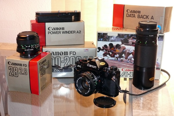

p.s. Here is a shot of the A1 with the lenses and boxes.
