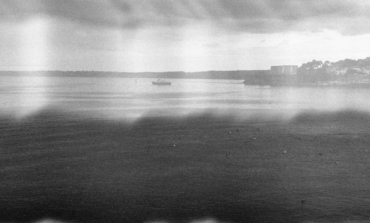

I have just bought a Canon A1 and took it out for a test run at my local town. I developed the film in my usual way with another roll from my Olympus OM10 which came out perfect.
The test roll from the Canon A1 came out very strange indeed. I have tested the camera for light leaks, I can't see any. The shutter is working to time and without lag.
The only thing that I can think of is the bulk loaded film cassette has developed a light leak, I have never had problems with them before.

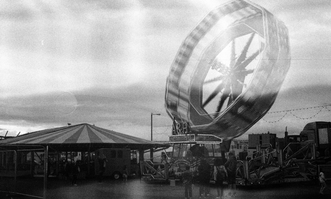

The first 19 images are full of light leaks, the last 5 are completely fine. Here are some images from the test roll, all shot under the same lighting conditions with the same settings.
Any ideas what could of caused this?
Cheers,
Mike.

MJLangdon:
I own, and shoot regularly, 3 Canon A-1. They are great cameras, and are almost indestructible unless you drop them on a hard surface.
I have never seen the problem you are having. Assuming that the roll exposed in the OM10 was also bulk loaded, I agree with your conclusion that it must be the cassette.
Hope you find a solution to your problem.
Regards,
Darwin

Just finished developing the second test roll, all photos have come out perfect so it was the bulk cassette leaking light.
