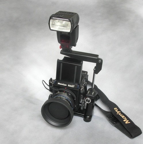

This shot is to illustrate an issue with using the Canon off camera cord if you also use the Mamiya left hand grip. There isn't enough room for your hand, and for the cord head. A PC sync cable is a must (of course, I failed to plug in the strobe end before I took the shot....I was in a hurry..... :smile:

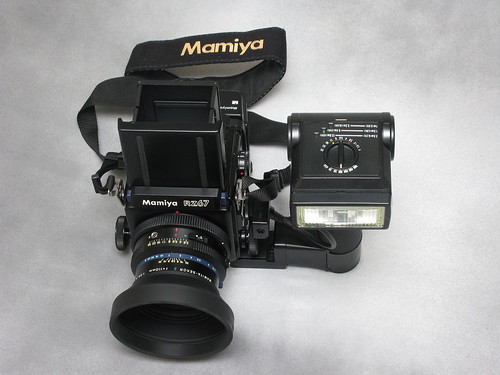

Someone mentioned that if you don't already use the 580EXII for Canon gear, that a cheap strobe would be in order. I agree. My favorite combination is the 533G handle mount strobe from Canon. They cost about $50 at a place like KEH, are bullet proof, powerful, bounce, and the tall handle mount fits the RZ perfectly. Even the exposure eye/hotshoe sync cord head clears properly. The grip is also rock solid, and more comfortable than a Mamiya grip. Go figure... You can also use a 577G, but it has an external battery pack (only), so it's not exactly ultra portable....
