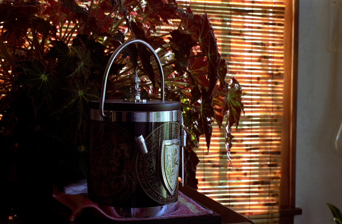

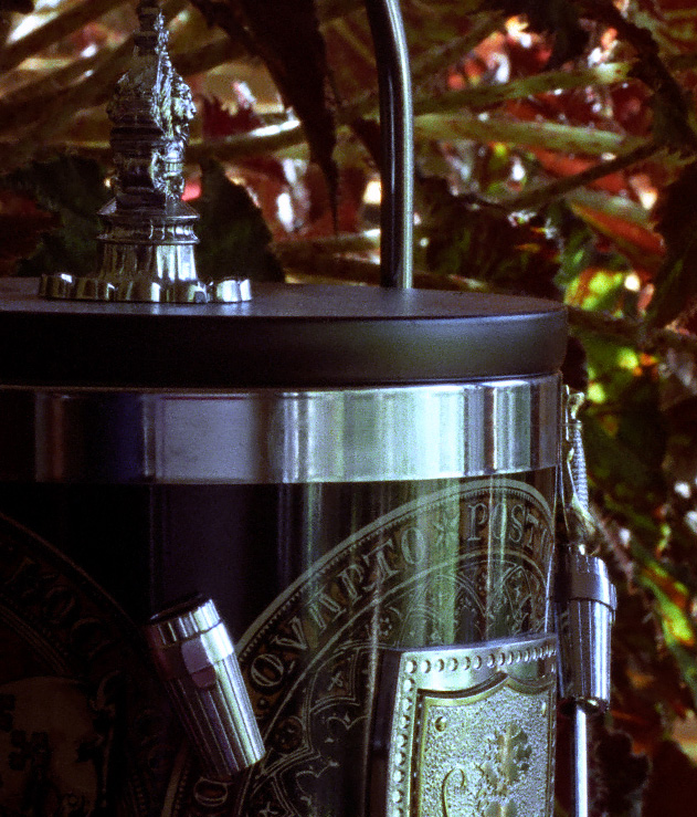

The FD 35-70 f2.8-3.5 is the keeper. In it's day it was considered an outstanding lens. You could prove it with one roll of film and shoot one third of it with each lens using the same range of apertures. I have no doubt that the f2.8-3.5 will outperform the others provided that it is mechanically and optically in good condition.
I have the FDn version of this lens and I've never been disappointed by it. I also have the later FD 35-105 f3.5 lens which is acclaimed by many. Both are large and heavy compared compared to similar zoom lenses with slower maximum apertures.
When Canon designed the faster zoom lenses as premium products they also paid attention to the optical performance and these lenses sold at quite a premium to the slower lenses. There was an FDn 35-70 f4 zoom which was tiny and sold as a kit lens with the early T50 and T70 bodies which was a very ordinary performer.
The attached pic was shot around 1984 on Fuji colour neg. Not sure if ISO 100 or 200. Probably tripod mounted and maybe invoking the close focusing of the f2.8-3.5 zoom.
