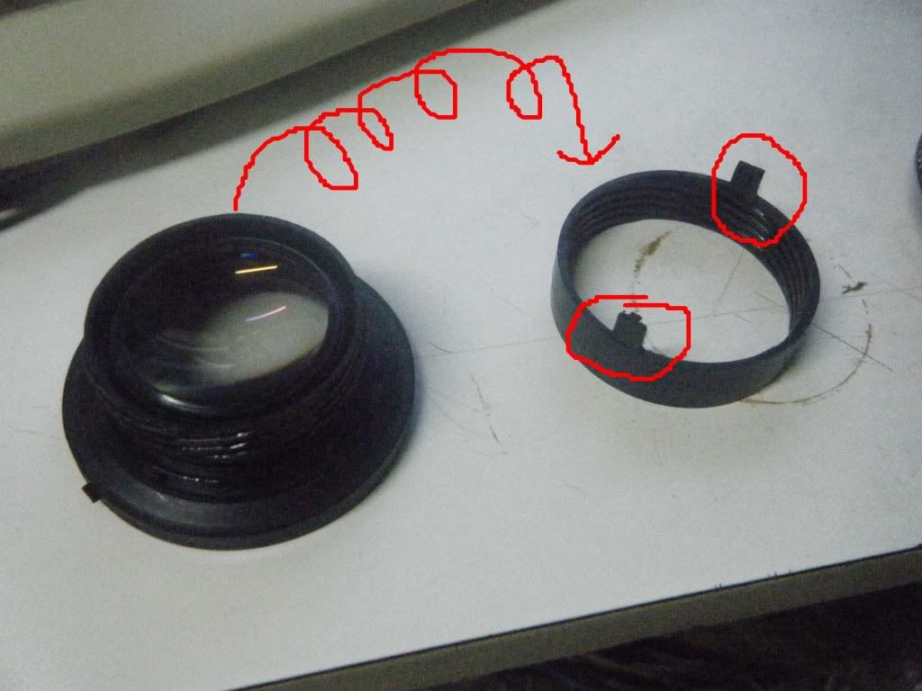

Okay, here is what I am working with.
This is the front element, the part next to it is what broke.

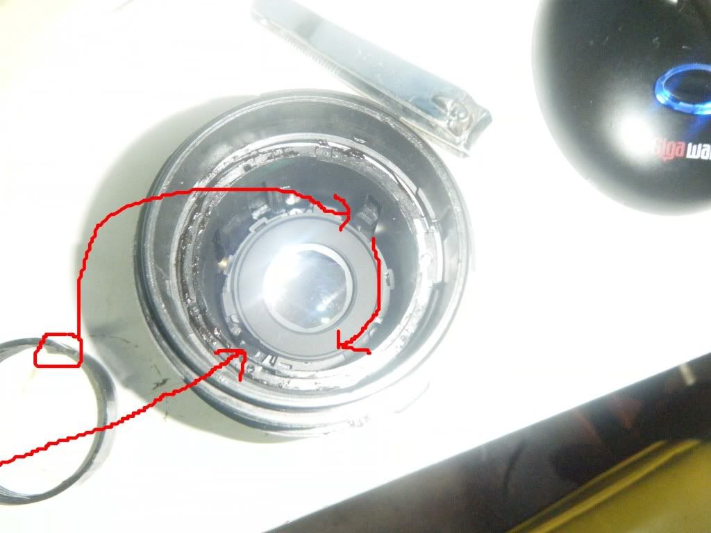

This is where it is supposed to be, as noted by the arrows.
So basically I have to find a Canon 35-70? I'm going to go check the pawnshop up the street see if they have one. Someone brought it a ton of old EF Canon stuff.
Here's a part that looks like what I need but doesn't look like the part I have in front of me. I've actually thought about disassembling the original lens and just gluing the whole thing back together and being really careful when I handle the lens lol.
The lens I have is actually an EF 28-70 Macro f3.5-4.5 II. Looks like a great piece of glass just needs fixing. I need a macro lens for my Rebel.

Hi
yes the part on ebay is the same part - someone has removed it from a used lens and it is a second hand part (probably). The lens unit and the front barrell were seperate parts with different part numbers...
All you need is the barrell - which you can take from either a EF28-70 or a old EF35-70 lens - they were pretty much interchangable. Your only problem is that this is also the most common part to break...

I guess one of those noses is broken. In case there is space on the outside of the barrel, you could cement it with pre-heated epoxy glue and a lug on the outside.

it will fit. I can't recall the actual part number for the 28-70 barrel - but they were the same part as the 35-70.
If it's a bit loose then thats fine - I've used loose ones in the past without a priblem. If its a bit tight when you fit it and you zoom it then you can shave the "bumps" off the outside of the barrel with the edge of a scalpel/box cutter/razor blade...I've done this in the past when I couldn;t get the barrel I needed..
